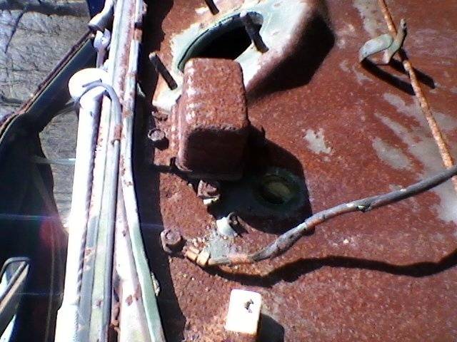

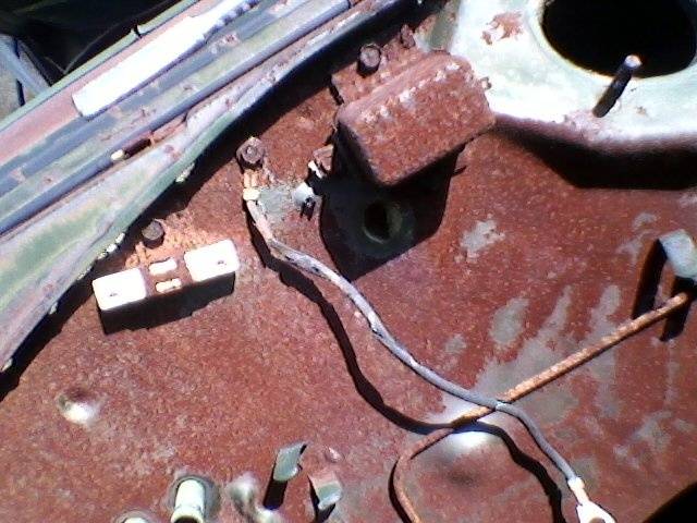

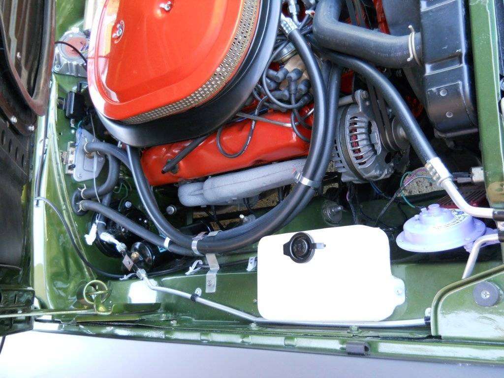

here's some pics of the parts car that I swiped some parts & measurements from but if you look closely they should give you some good reference points but I strongly suggest drilling a pilot hole first since you don't have any room for error than I just used a step drill bit to finish drill the hole which gave me the perfect diameter for the grommet.

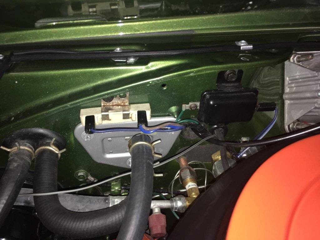

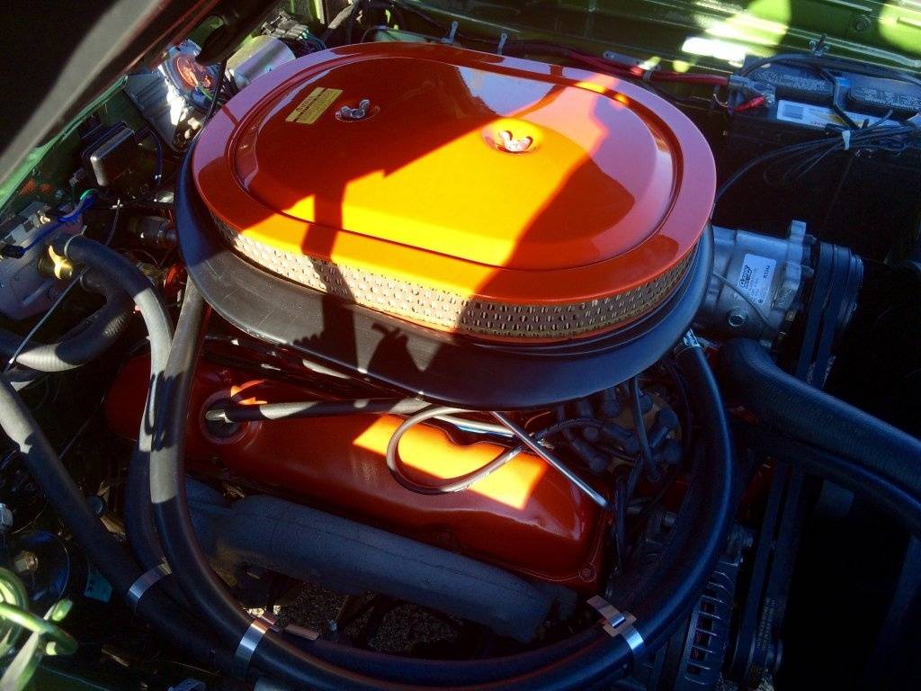

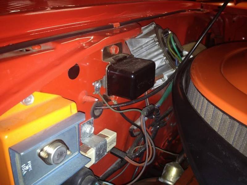

the other pics are of my car completed sorry I don't have any better photos but if you zoom in & follow the cable you can see where it goes in the firewall.

after looking at the pics I must of moved it to the left & not up
View attachment 421555 View attachment 421556 View attachment 421557 View attachment 421558 View attachment 421559
thank you for the pics. looks like where you ran the cable through is where I have a rubber plug. I am guessing it is a plug that holds the firewall insulation on. lol...i am not even sure how to even get my hand up there to pull the plug out or even see what the plug is. please confirm that what i am seeing is correct. i am zooming on on your picture and it is a bit fuzzy but looks like where you are going through the firewall is an outward indentation but it doesnt look big enough for the plug.
I had to drill my own hole.
right underneath the voltage reg is the vacuum line hole & i put the air grabber hole to the left of that almost where the factory one would be. You might want to take out your wiper motor so you can get a better idea were your drilling plus it will make fishing the cable down a lot easier.
Make sure when your done the wiper arms dont interfere with the cable.
