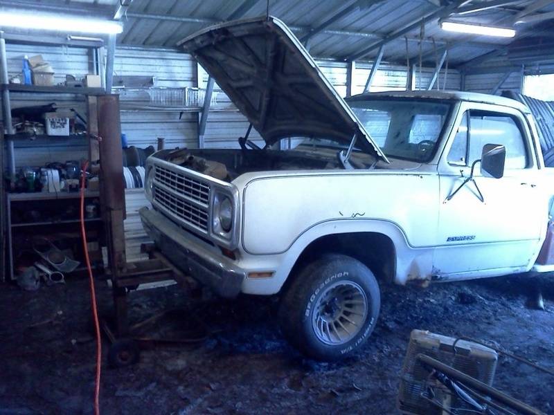

I got turned on to "air jacks" back in HS auto shop in the mid 1980's.
I now have two "gray" brand and I LOVE them.
I've made adapters from gm slot jacks for my 73 slot bumpers.
It's literally like having "half" of a lift.
They can also work in a dirt floor pole barn if you put enough 2x stock under them in the right places.
