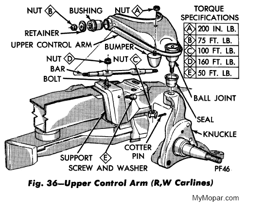

[SUB][/SUB]The 73+ B, R, F, M & J bodies do not use eccentric cam bolts like the 72- B and A bodies!

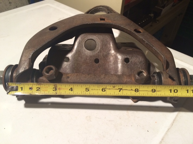

When you go to replace the upper bushings just burn the old rubber out with a torch and the 'bar' will come out easier. I replaced the bushings with the PST poly inserts so I didn't have to remove the original bushing shells.
There are slight differences in the bushing dimensions between the 73+B & R body upper control arm bushings and the F, M & J body upper control arm bushings. When I was researching I started a thread on the forfmjbodiesonly site and ended up answering my own question about the two bushing differences:
http://www.forfmjbodiesonly.com/cla...t-upper-control-arm-bushings.1283/#post-11985
I also did find out that for all these years and body's, the complete upper control arm assemblies will all interchange (bolt right up) however modification/relocation to the shock mounting hole is required.
