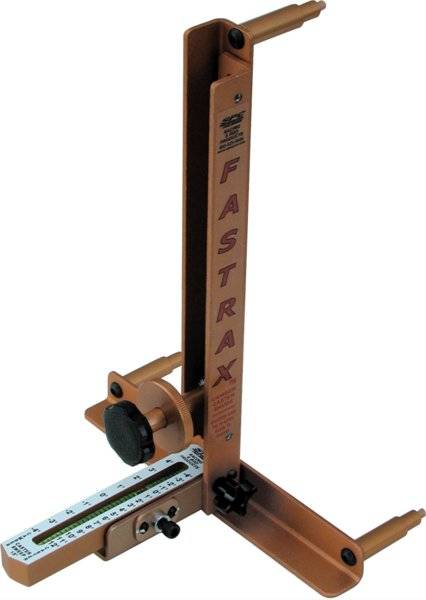

Get you a caster camber guage, a tape measure, and a friend that can hold the end of the tape.

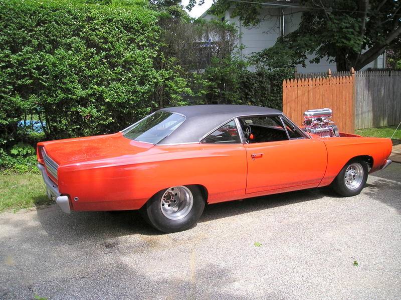

I was an alignment tech for a few years lifting the rear of the car high rnoeno to get the rear sensors on will not cause any issues ! On a newer car yes ,these old cars are easy to do I can get them dang close with a tape measure in the shop so I can drive them to get alignment!
I had the same thing on my 64 Dodge. The local alignment guru said he couldn't do it properly as he had to go off the rear wheels, and his equipment would not fit. He sent me to another " old school" shop 50 miles away, and they did a fine job.........MO
I just had the 64 wagon and the 66 Barracuda aligned and the shop had a new rack. There were no problems with that shop doing it. Both drive very nice.
That's all I did. Some straightedge and tape measure work, then drive it on over to the alignment shop.
I figured since the car had never been in a wreck that it had to be in the neighborhood.
It was. :-)
