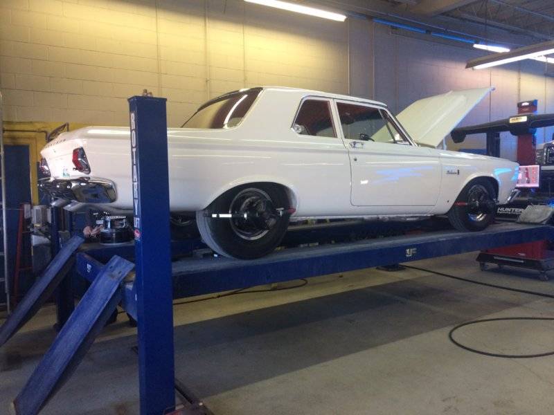

So Back to the issue at hand. I Have a few issue with some of the advice I been reading through and I'm sure it was meant with best of intentions but lets look at the facts. First off the car is fast, Make about 750hp and will pull the front tire if I heat things up on the street!!! It also has a Locker so it gets a bit twitchy when peddling in and out the gas. I don't think I want to be aligning my handfull of a steet car with strings and levels at home. Toe and camber are one thing but how do you accurately adjust caster with a tape measure and level?
Not a single piece of the front end is factory, QA1 K frame, QA1 Tubular uppers, Boxed lowers, QA1 adjustable strut rods, Borgeson steering, etc. So basically who knows how bad it's out... Also the rear wheels are beadlocked and don't have a lip on the wheel to grab! I understand the issue and I am looking for a way to align it properly. I've spent all day Friday calling around to every alignment shop I know and even called some of the local race car shops to find out what hey do. Seems none of the local shop do their own alignments. So I got a few numbers and made some call but at the end of day they all have newer machines that have fixed heads that won't clamp on the rim.
This is what I got so far, I had a set of 15x8 summit wheels with 275/60-15 tires that laying around so I put them on. They are about 2" shorter and 6+"s narrower. I'm hoping what ever shop I find can jack up the car about 2" to clear the quarter or maybe swing the head inside the quarter. I will have to jack the car anyway cause it sits about 2 1/2" lower with the little tires.

I had the 65 aligned by the local "go to guy" for muscle cars and hot rods. He did a 4 wheel alignment. I had similar rear wheel clearance issues, but I have a wheel spacer that we were able to remove to get the needed clearance for the alignment.
That would probably work.

Update, I called over to Gene at Wild Rides (A local race car shop) and asked him what they do. He gave me the number of two places they take their tubbed cars so I gave one of them a call. After speaking with the alignment tech he said he would try and get the rear heads on but if he couldn't he would use the front heads only and that he does it all the time with hard stuff like mine. So I have an appointment for early next week and I'll let you know how I make out.
