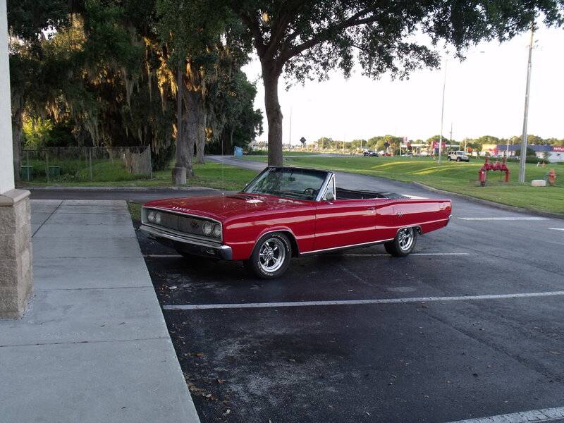

To provide a real-world example, my ‘68 Coronet has some decent bolt on suspension upgrades; besides fully welded frame connectors we got 1.0” torsion bars, tubular upper control arms (that provide more caster than stock parts), 1” (bolt-on) sway bar, Borgeson quicker ratio steering box (more of a modern car feel than the original numb Mopar P.S. box), new heavy duty leaf springs, spring hangers and shackles. This is all riding on garden variety BFG radials and nuthin' fancy disc brakes.
Just this week I ordered a set of QA1 single adjustable shocks and am waiting on delivery.
Good shocks round out any suspension package by controlling body jounce and rebound inertia. Based on reviews people mostly have good things to say about these things. They ain't cheap so hopefully they live up to the hype and make some sort of noticeable difference. Honestly, just about anything would be an improvement over the current Mopar blue pogo sticks in the rear and KYBs in front.
It’s a basic package but it handles predictably and tracks well. It’s not your look-at me fender flared, ultra low, rubber band tire, Pro Touring/G Machine/road race/autocross bling mobile, just a fun, mostly stock style cruiser which gets driven often in lots of different situations.
And let’s face it, this wasn’t a dirt cheap deal by any means but its nowhere near the top of the suspension mod food chain and should be within reach for most people that mess with these cars.
