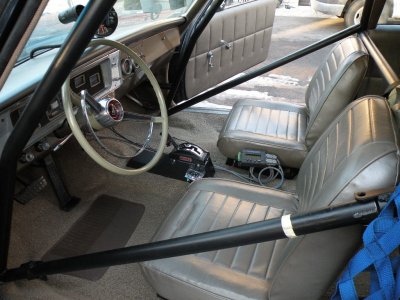

THEY are all bought from steele and distributed throughout the mopar industry from different vendors. what you are experiencing is normal and will get better over time. they need to soften up some. i have the same problem also. you got to slam the door otherwise your door doesnt close all the way.

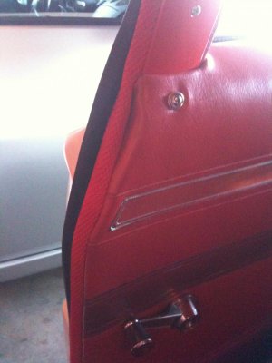

Joe did you see those you asked for via email? Is your windlace pressed all the way on the pinch weld? Check how mine is tucked under the door panel and the metal post trim and compare to yours. If it sticks out too far it will interfere with the door.
They do take time to break in like SSR says.
