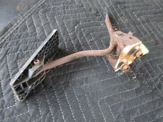

The stock pedal on my 70 does not have enough throw for my EFI.. I am considering a pedal from Lokar or Control Cables Inc.
Glad you brought this up- my right ankle does not bend very far due to an old injury, I will look into the 71-up pedal setup
Oh yeah like it^^^^
Is that the 71-up pedal?
71 up[?] pedal assembly like that will work. A,B, and C body pedal assemblies are almost identical as shown, and should be super easy to find.
i also believe the throttle cable attachment is the same as the floor mount pedal, so no mods needed to attach your original cable to the suspended pedal.
