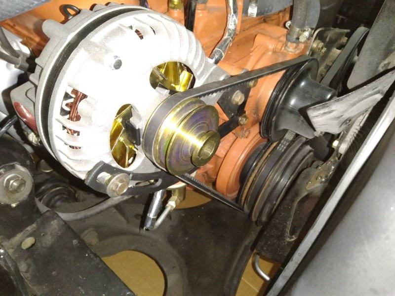

Big block brackets look longer - but the angle of the kink in the middle is different.Here's a crazy thought: are big block tensioning brackets the same length as the LA brackets??

Depending on which stock we talk, because later stock alts used that same smaller pulley.The Powermaster alternator has a smaller-than-stock pulley to make the alternator spin faster. The instructions may have even said that you might need a shorter belt.

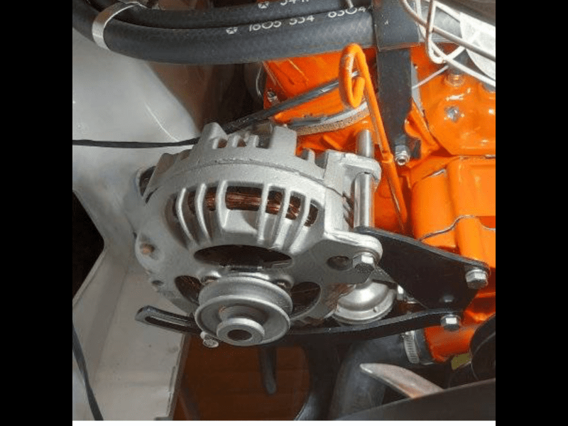

Actually, I grabbed another small block bracket, and Frankenstiened a longer one. I grafted in a piece of the other bracket, painted it, threw it on... then took Nadine for a brisk romp through the countryside... we're back in business! Total cost - $0@Hilljack68 jack68 Well you get the belt????
Except the alternator is mounted upside down. The adjustment bracket should be on top?? It appesrs to be on an LA engine......Actually, I grabbed another small block bracket, and Frankenstiened a longer one. I grafted in a piece of the other bracket, painted it, threw it on... then took Nadine for a brisk romp through the countryside... we're back in business! Total cost - $0View attachment 1690153
