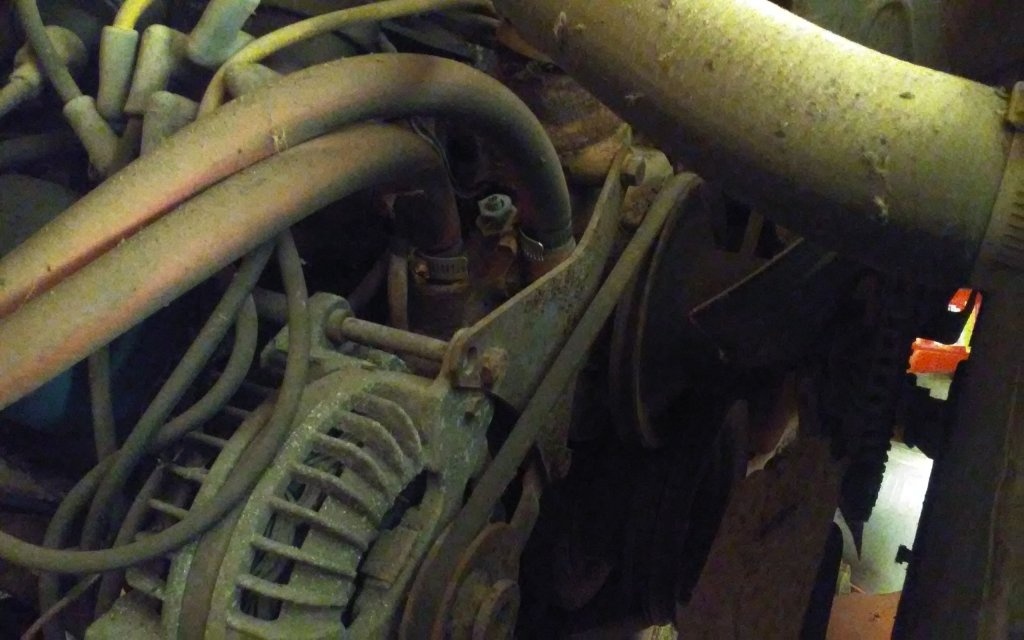

When I told them the correct water pump housing they sent me 66 and newer bracket that one didn't work and then they sent me 67 and later and that one didn't work either. 246-8007 that's the water pump casting that I have on the car maybe I'm doing something wrong I have no idea
The HerbsParts #007 will fit your pump. Are you using the correct alternator and pullys?
Here is picture of how to install you brackets. Please excuse any dirt a rust. The spacer that fits in the alternator is missing but has never caused problem.
As far as I know yes I've never touched anything on the car I bought it the way it is as far as I know they are the original pulleys
