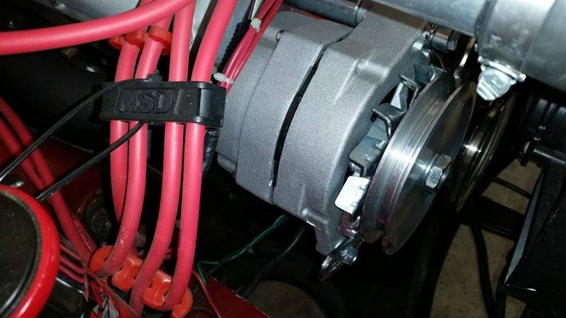

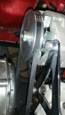

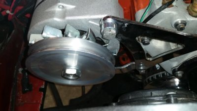

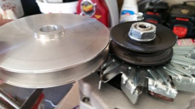

On my Coronet I just bought a Chevy 1 wire alternator 80amp (about $100) and bolted it onto my stock bracket with the help of some washer type spacers. Worked fine. No problem. In the one picture you can barely see the long steel spacer at the top of the picture that I bought at the hardware store to finish the mounting of the alternator to the block.
I bought a 5" pulley from summit to spin it a little slower and save horsepower. No problem running my Holley Black fuel pump, electric water pump and electric fans. I had 2 Optima red top batteries in the trunk. I ran a 10 gauge wire from the alternator hot stud directly back to the batteries. In the bottom picture you can see that 10 gauge wire coming up thru the floor of the truck and connecting directly to the positive post on one of the batteries.
Although I did charge the batteries between rounds (when I had time) but probably didn't need to do that. I never worried about the batteries not having enuf charge to start the car...they always did.
And most important when the motor was running and spinning the alternator I never worried about the water pump, electric fans and MOST IMPORTANT never worried about the MSD Ignition system having the 13volts (or so) that was being sent back to the batteries to run the Ignition system.

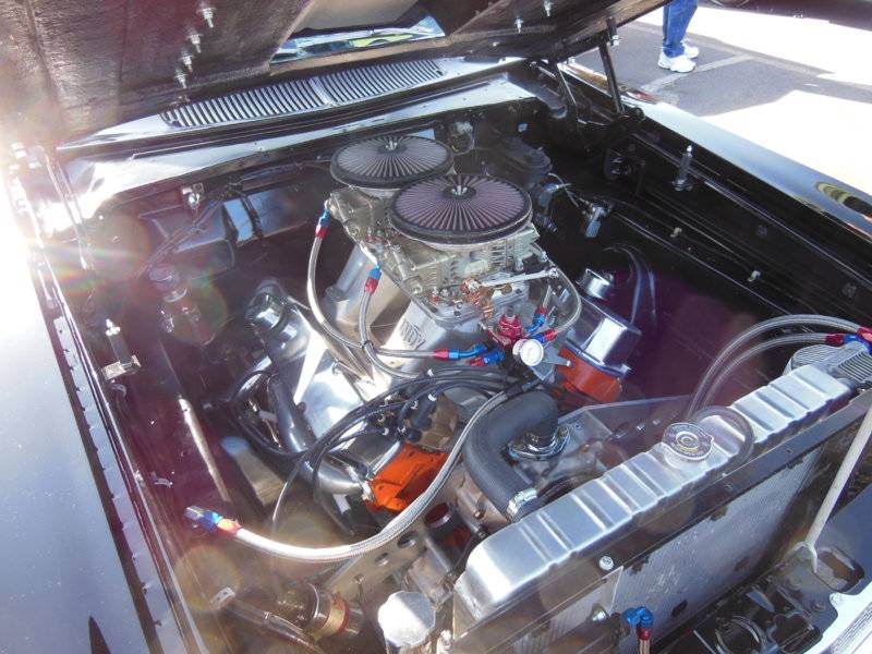

I went with a Powermaster 95 amp unit. Retains the factory type case and I think it was under a hundred dollars, not sure as it was years ago.
I used a late 8 0's early 90's factory alternator. Wires the same the rear is deeper but clears the head. Same brackets. Close to 100amp. Even polishes up nice.
Doug

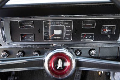

I use a Tough Stuff alternator, i think its 130 amp, looks stock and set up as a 1 wire. I eliminated the AMP gauge and put a volt gauge behind the stock gauge face, that's why the needle is on "D" when the car is off, I set the volt gauge to 12.5 volts in the middle so i know if the alt is charging or not. I also added 2 10 gauge wires to the alternator, one goes to the firewall like stock and the other goes directly to the battery.

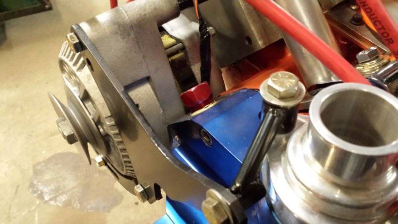

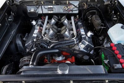

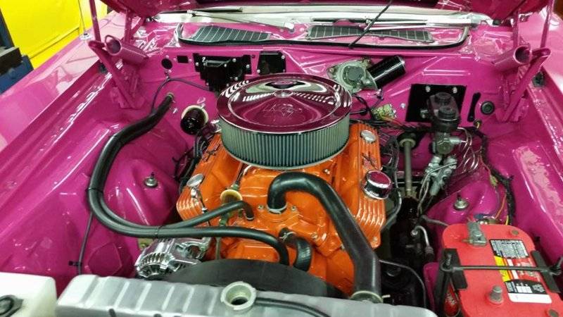

1 wire mini alternator , 130 amp, volt meter bypass, because i also installed 2 fans and almost done installing electric water pump.went higher amp output so as the unit would not be putting max amps all the time. my 1700 cfm fans will blow a 20 amp fuse. alternator at low center in pic.

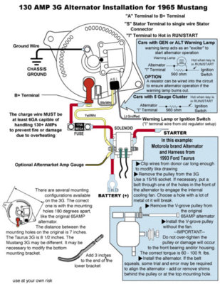

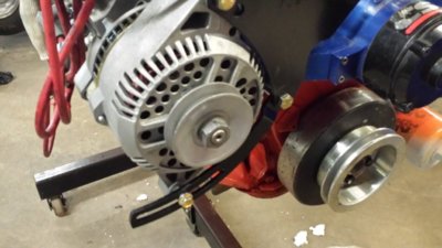

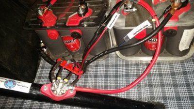

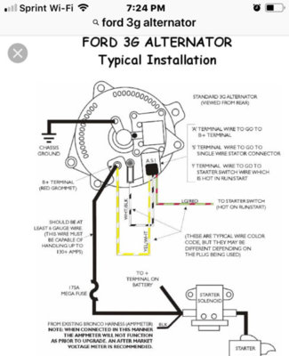

I’m partial to the ford 3gen alternator it’s 135 amp rated similar in size to the stock alternator and easy to wire

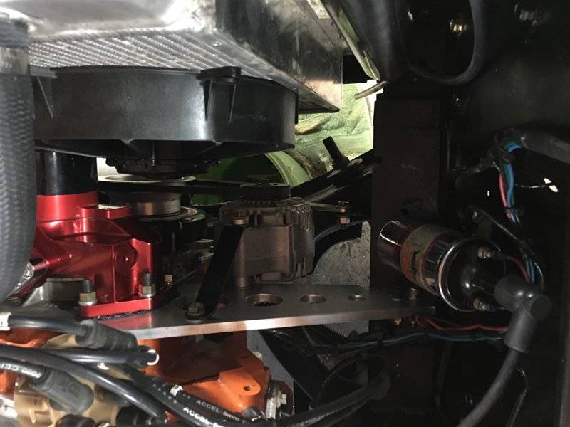

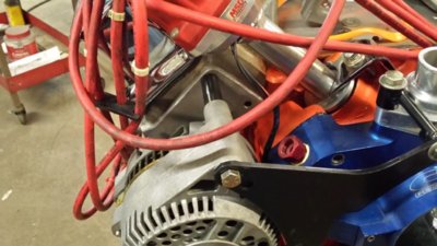

here's a better shot of my 130 amp 1 wire mini alternator with internal regulator..with dual fans, msd, electric fuel pump, electric water pump, and everything else,,more is better. moved alternator tensioner arm to frame rail.

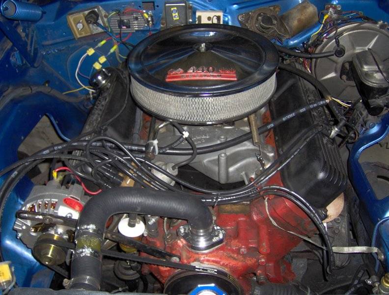

Nippo Denso from a 89 Dakota 120 Amp available from any parts store. Have to make/modify the brackets some but easy to come by.
