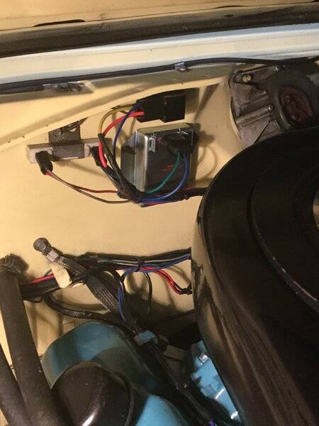

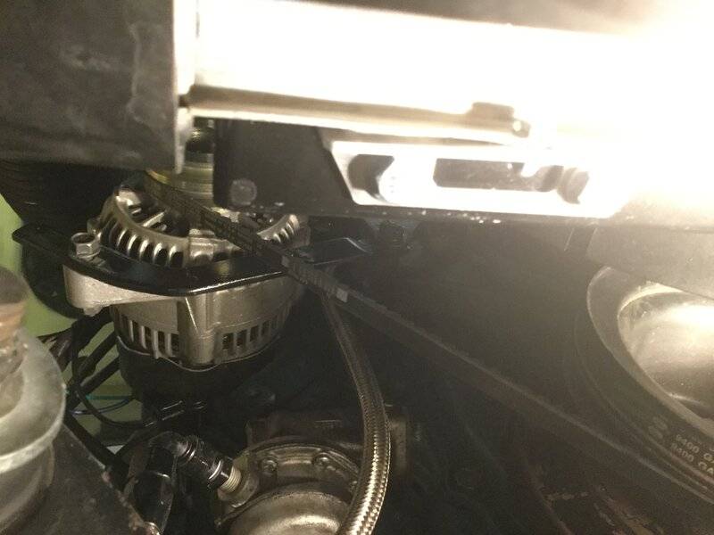

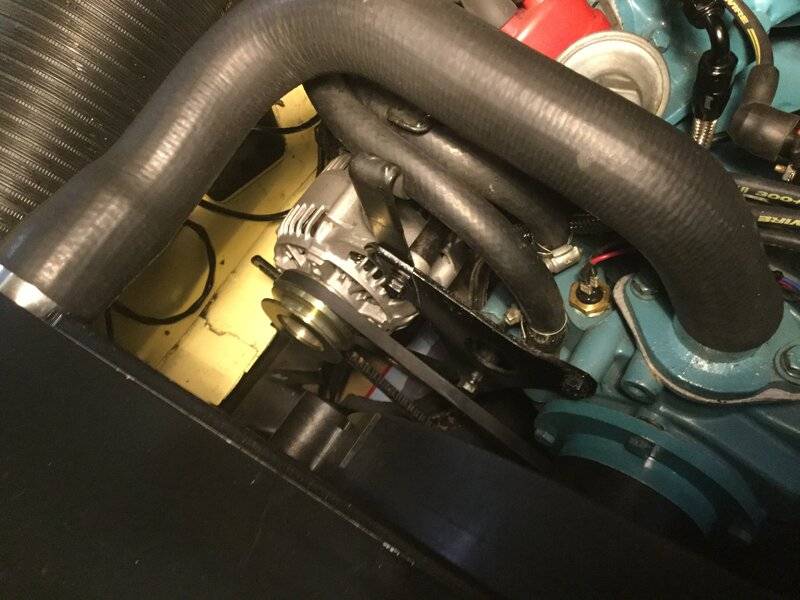

I got the new alternator swing bracket fabbed up, and got it installed. Seemed like it fit pretty well; a little close to the head at the backside, but not bad all in all. Wired it up with a new voltage regulator and everything seemed to work..... too well. I was seeing as much as 17 volts when it came off idle. Wiring seemed correct, so I called my wiring guru. He had me feed the Reg straight from batt +. As soon as I did that, voltage leveled at a rock solid 14.4. So I wired in a relay to feed B+ to the reg when the key switched on. This seems to be working just fine.
