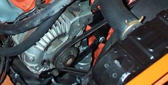

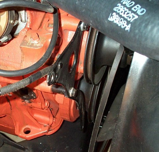

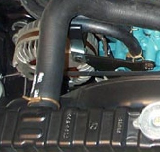

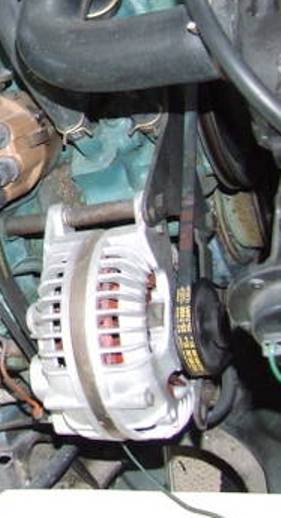

Hello Everyone I was wondering if someone could send me a couple of pictures of the placement of the Alternator for a 68 GTX, engine is 440. Also if anyone has a picture of the bracket that it mounts to and how it mounts that would be awesome to.
When I started my restoration the Alternator was missing from my motor and I'm not exactly sure how it mounts to the motor.
Thanks in Advance
Here's some pics of some of mine, not specifically 68 but various 65, 67, 70. 68 is basically the same & uses the heater hose bracket shown on the top bolt.
