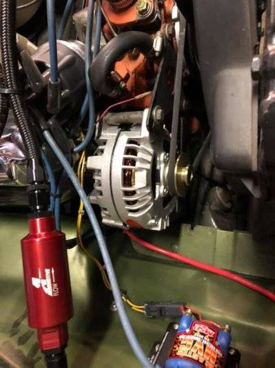

I like what my son did which was upgrade to this 100 amp one wire alt.Its nice to put the higher output on his car since we will be adding an electric fan and maybe a few other things. I like that it looks like a stock Mopar alt but it has an internal self exciting regulator and will put out 100 amps if needed and it one wire. It is a Power Master and it works great. You can use it on any older Mopar as it will only put out what the car needs so it will work fine on your car and if you upgrade things later you have some extra output if needed. And being its a one wire all you use is the output wire. Ron

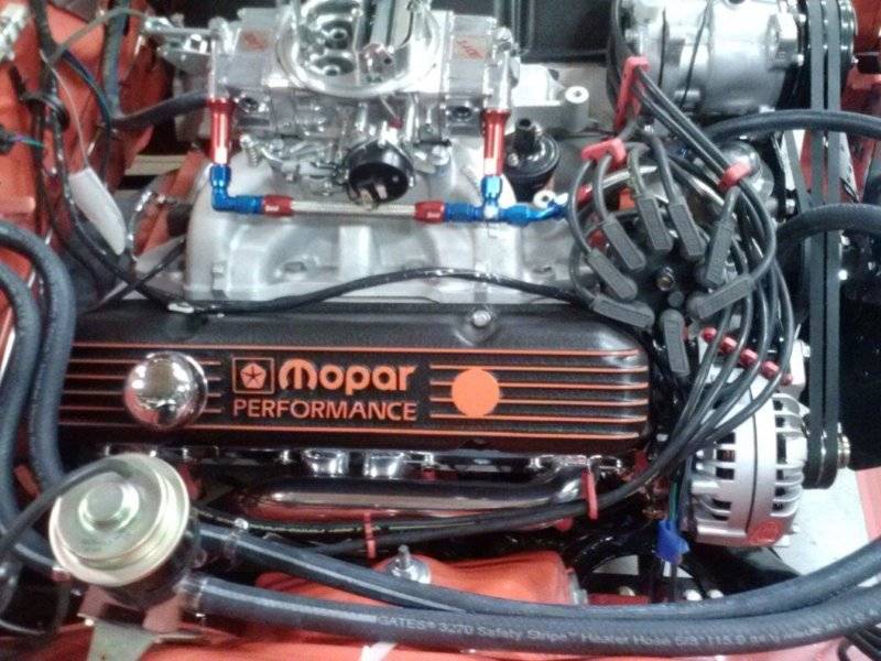

Powermaster on mine
