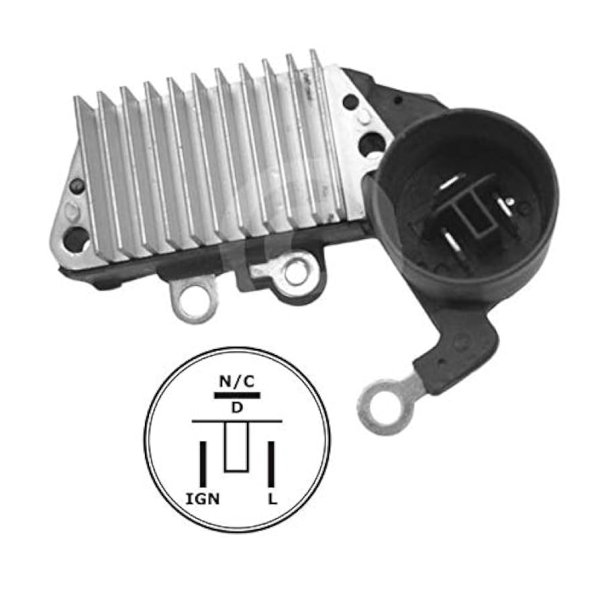

The major advantage of a one-wire alternator is the benefit for the ease of installation. @idle RPM a traditional alternator with external regulator will output comparable amperage to the output of a one-wire alternator. Another downside of a one-wire alternator is that if its internal regulator goes bad the entire one-wire alternator @ higher cost must be replaced compared to the cost of an external regulator. One other consideration is that for the newer one-wire chrome alternators, one must be sure they are grounded well through its chrome plating.
