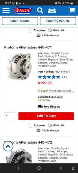

I have a 76 Doba that has a stock alternator . I believe the amperage is 60amp . I do notice at idle it drops in the 11's when the lights are on , it then jumps to around 14v when driving. The dash lights are super dim. Now do you think an upgraded alternator will fix that problem? If so how many amps should I jump to ? 110 or 200? I plan in the future to put a simple stereo system with a sub. I was looking on Summit , does anyone out there recommended a brand ? I was thinking about Powermaser , Tuff Stuff or even then Proform one I came across . I would like a direct bolt on but if there is advantages of something better, I'm open to all you're opinions .
