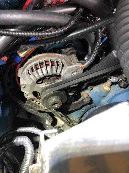

Hello fellow mopar buffs,
I have a 1974 Plymouth Roadrunner which I got about 5 years ago and have been working on and enjoying since. I’ve come to an issue recently of not having a powerful enough amp output from my stock alternator. It’s rated at 100 amps, but I have an electric fan I installed with my new radiator recently that draws a ton of power and it won’t allow it to keep my battery charged. I’ve looked at some solutions involving getting some higher output alternators, but believe I will have clearance issues, I’m already maxed out on space with what I currently have. I do have AC in he car. Does anyone have any suggestions or have found a solution/part that will get me over this hump? Thanks in advance.

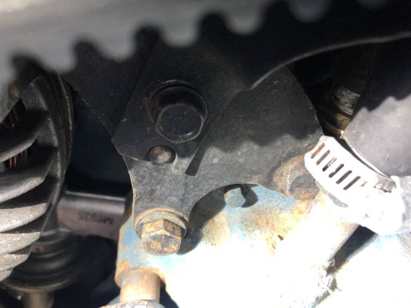

Looks like there's tons of adjustment left in that alternator bracket, would longer belts allowing the alternator to be swung out help? If you don't mind a little work modern alternators are much more compact. Check out Summit and Mancini. I'm running a Denso, big alt in a small package.

That pulley is already the small one

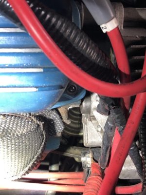

Thank you everyone for all of yall's advise. Iv'e looked over all the resources posted and decided to upgrade to the one wire 130 amp tuff stuff alternator. (Great part and customer service)
I opted for this over power master since no mounting bracket modifications were needed when installing on an engine with a/c. Ended up rewiring everything on the alt to 4 gauge wire (7' positive to battery & 4' ground to block) as well as eliminating all old wiring for the external voltage regulator and ammeter. Also shortened and upgraded ground wire from block to battery with 4 gauge wire and added a voltmeter. All this being said, I'm still having issues with my car when the electric fan kicks on. In idle with battery connected I have 14.6 amps at the battery and 14.8 at my alt. When the fan kicks on it drops to 12.4 at the battery and 12.5 at the alt. If I also add my headlights to that it will then drop to 11.9 amps (not good). So needless to say after a good bit of time and money spent on this project I'm back to square one. I think I did a pretty thorough job of updating all wiring involved, and cant see why this new part wouldn't do the trick.
Anything I missing or any suggestions? Higher amp alternator? Also have had to replace the starting relay twice in the last 6 months including after the new alt.
