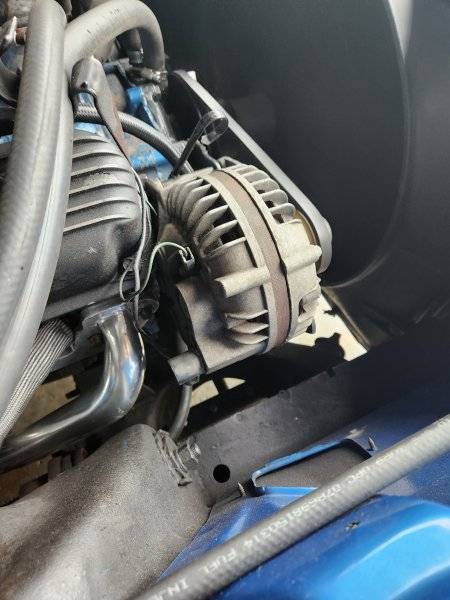

72 with 318. At idle I am only getting 13.5v at the battery. If I increase rpm is rises some, but only to around 13.7.
When driving with headlights etc they will turn off sometimes and at idle the turn signal blink very slow compared to a higher rpm.

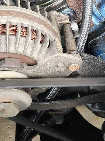

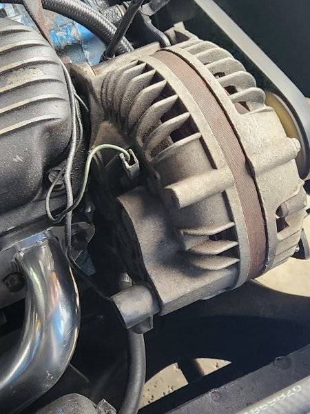

Also any idea how to identify this alternator only has a a number stamped on it. 2005191

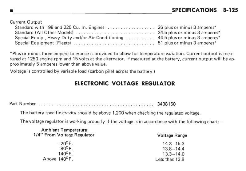

According to the title of your inquiry, the original alternator would be a round back dual field, single groove sheave, and using the electronic voltage regulator......that is IF no one has changed it to a square back design. It would use the electronic voltage regulator. Typically, the standard alternator was rated at 46 amps output, slightly more if the vehicle had A/C. If you have access to a FACTORY SERVICE MANUAL (FSM)....follow the procedure for load testing the alternator. IMO....DO NOT TAKE THE ALTERNATOR' TO THE AUTO PARTS STORE AS THEY CANNOT DUPLICATE THE FSM CONDITIONS. Its possible that the alternator has a bad diode. This would reduce the capacity by half, but under light load, the alternator may produce correct voltage.

72 was the first year for the SQUAREBACKS ALTS...
roundback ”dual fields” was 70/71 only deal.
