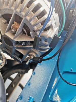

This is likely the first of a few questions regarding wiring up my 1970 Satellite now that the 440 is in. I ordered a new engine wiring harness from Classic Industries. I also have a wiring diagram for my car. The wiring diagram shows a dark green wire going to field, and a dark blue wire goes to field, and then the battery wire(black)gets pinched between the two nuts. That's what my old harness was like, except when I hooked up the alternator wires with the old motor, I must have had the blue and green wires backwards, because it melted the wire. I replaced it, switched the wires, and no more problems. Now I've got the new wiring harness, and there are two blue wires going together into one connector, the lone green, and of course the battery wire. The diagram says both go to field, but doesn't specify which. Having melted the wires before, I don't want to make the same mistake again. So my questions are:
Why two blue wires instead of one on the old harness?
Why are the two field poles not marked specifically when they are obviously not the same?
Automotive electrical is a huge weak spot for me. I'm sure there is a simple answer. Thanks for the help.
It is so simple! The field wires can go on either terminal. That’s not why your wire melted last time.
That's what worries me. I'd rather have made a mistake and then figured it out than not know why it happened. All I did was change the wires around and the problem was solved. Must have been something else I did. Anyway, appreciate the answer.
R413 is correct....it does not matter which wire gets connected to the alternators field connections. The double blue wire brings 12 volts to the field; the green wire goes back to the voltage regulator. The voltage regulator completes the circuit thru an internal transistor to ground, via the green wire. This is why it is so important that the case of the voltage regulator is securely grounded. The regulator turns the alternator field current on/off to keep the alternator output voltage at 14.5 volts (+/-) depending on the battery's state of charge. To insure the regulator's case is grounded, I put the engine's ground wire under one of the regulator mounting bolts. Just my opinion of course.

just passing by but 1 spade terminal is bigger than the other. Like F1 F2
If I were to guess, the green goes on the bigger brass connector
