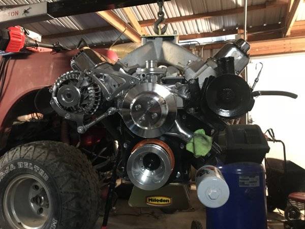

Ya you got it right, 440 source has some nice brackets at a good cost. I got a 100 amp unit from a friend here, pulley and bracket from 440 source.
