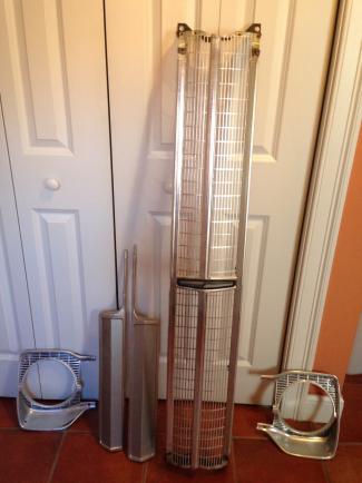

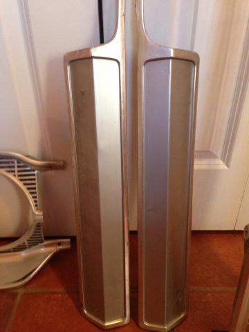

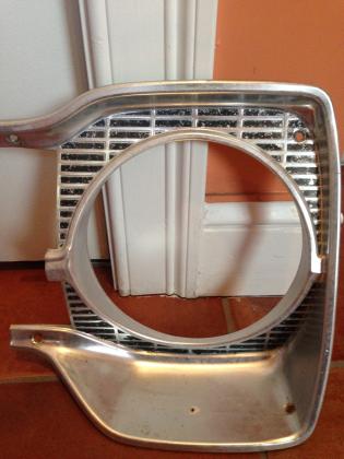

Looking to have the aluminum grill, headlight surrounds and tail panel section of my 65 Belvedere II refinished. Aside from the King of Trim in CA, who/where else would you recommend?

I've done a fair amount of stainless and aluminum polishing in the past. Sill plates, windshield trim, motorcycle engine cases, etc....The difference here is I would like the grill, headlight bezels and rear deck plate reanodized. Otherwise, I would do them myself and just keep them polished. I feel the anodizing would provide long term protection.

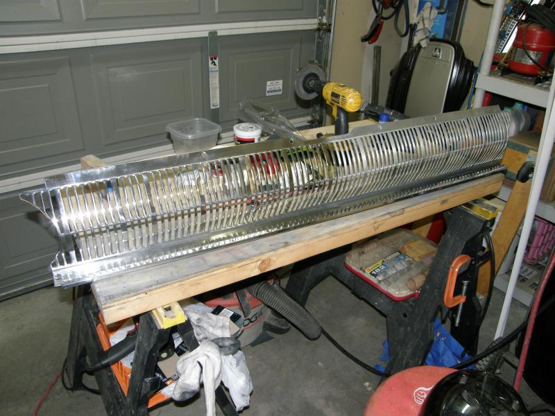

I still do the grilles, working on a 64' Dodge Super Stock at the moment. You could do all the work and then send it out to be re-anodized and then do the painting.
Did this one awhile ago. The picture didn't do the grille justice, but you get the idea. Only half done at that stage and still needed paint.
