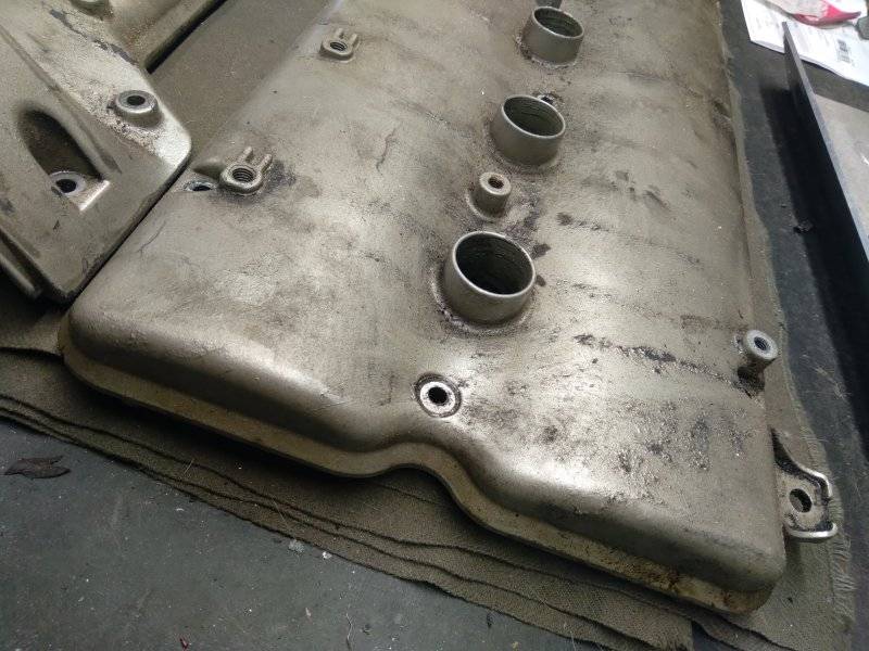

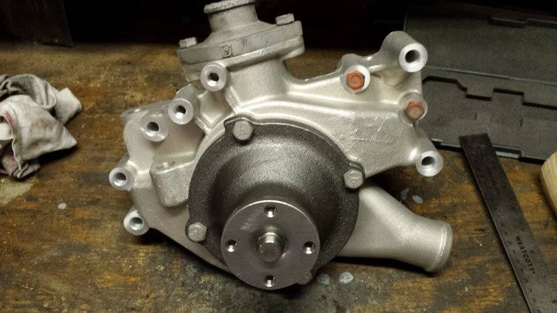

From a metal finishing perspective:
I've had the pleasure of working up a few of the 440 Source housings. Unlike most parts that cross my bench, they're quality pieces without a bunch of casting flash and excess and require very little bodywork. The aluminum itself is also high grade as evidenced by the fact nothing oozes out of them after a few hours of outgassing. They look beautiful when I'm done.
o
Thanks for all the info, I might just try the 440 source one

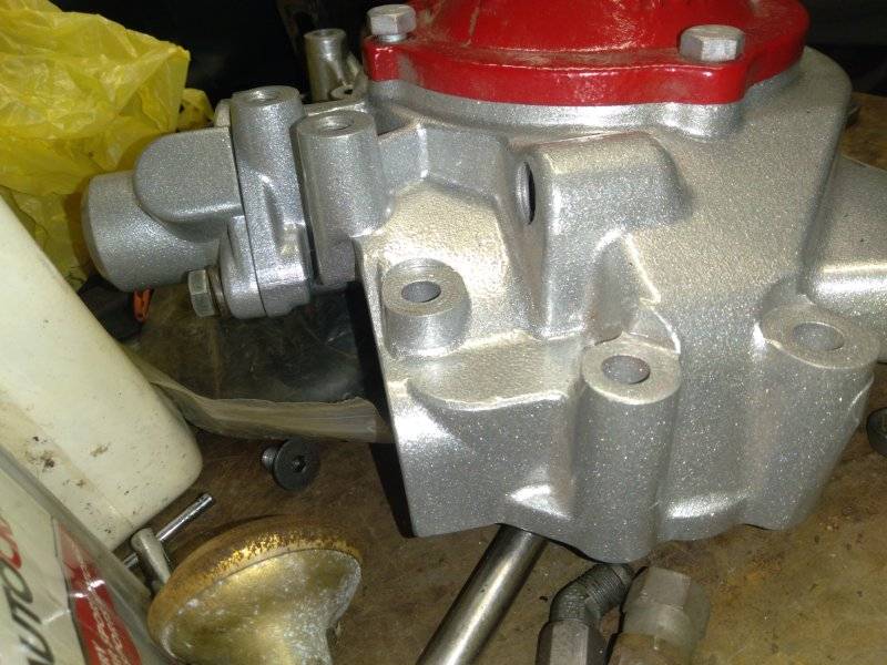

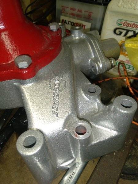

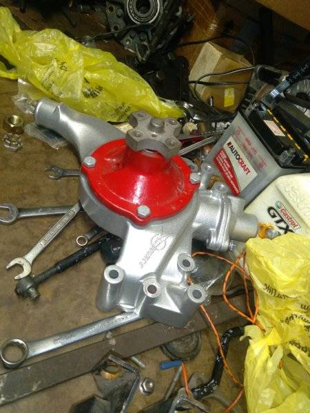

Here's one of Billy's I worked up.168313150361839494964012995704.jpg1683131545916263239149686057989.jpg16831315816006691334247239838036.jpg
I'll add a shameless plug that all FBBO members enjoy a labor discount, and military/law enforcement (past, present and retired) get a bigger one.

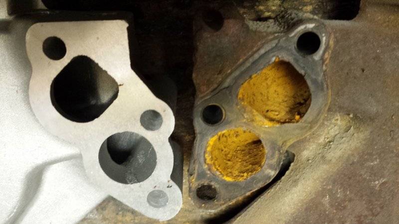

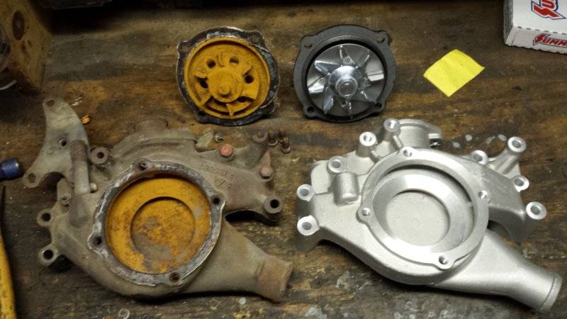

Compared to the original cast iron housing...
