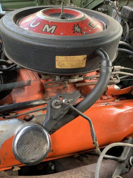

Am i in for a transmission rebuild?
I was replacing the water pump today which took 4-5 hours so i had no real time for the transmission.
But watch the 2 videos below that i made of the kickdown linkage.
Is this how it's supposed to be? Its pretty loose.
And this is just the top end. the guy i was talking about noticed it being loose on the underside when the car was on a lift.

When you open the throttle all the way manually at the carb, the the kickdown should be tight to the stud the throttle cable attaches to as possible.
Your return spring for the kickdown should pull the linkage reasonably tight (no gap) to the stud when at idle.

Does this look normal? I was flooring the gas pedal in one of the 2 videos and recorded what happened with the linkage.

I'm interested if there could be a problem with the linkage(s) or something?
Something i should look out for?
Also, I've had lube guard work miracles, some manufacturers use it
It’s called throttle pressure linkage and it is critical for the trans to know where your foot is on the gas pedal. It increases the internal pressure as the load increases. 200-300 miles without it is enough to ruin the trans.
#1 problem in the video is common on a 727/904. When it sits for week or more when it starts put it in neutral before you choose D or R to move the car so it can circulate the fluid.

I think this might a little over the top, it comes down to a basic oil level checking and top up if required.
Next thing is to ensure the throttle linkage is set up and properly adjusted, which is described in the manual, suggestions from here or can be seen on You tube.
All required is some feedback from OP on these things so we can assist in some further troubleshooting.

Where are you now on throttle linkage adjustment? Did you do any check or make adjustment?
