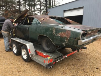

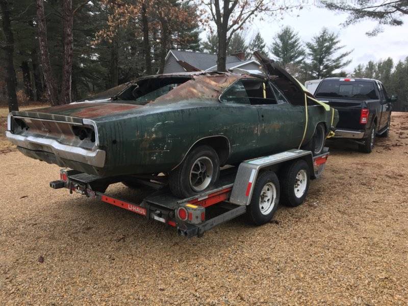

Well, I got a car but it had a vinyl top so it was toast. The sail panels are rusted through on both sides as well. I kind of want to keep the true sheet metal but need to to the qtrs on both sides alon with rear window channel and rear panel. I got a complete donor panel top along with the car but am torn between the donor piece or going AMD for all the repairs I need. Anybody done the AMD repairs or have some info on welding in a complete top section.

The top came with the car. I am a little apprehensive because its such a huge piece. I was thinking of just taking the car to AMD in GA to make sure its done correctly. The right qtr has a deep fold on top right near the edge and is rusted out on the bottom. The left is ok minus the sail. I have never gone that deep into sheetmetal before.

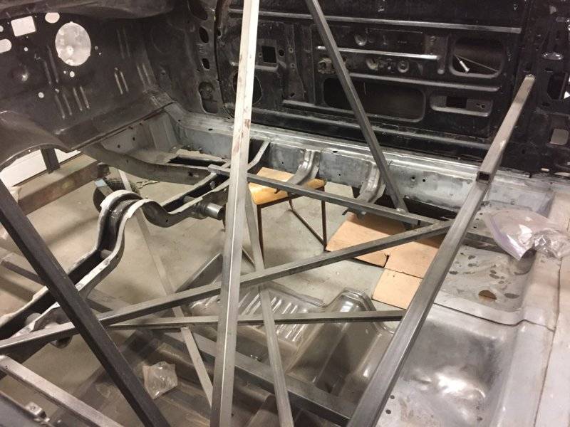

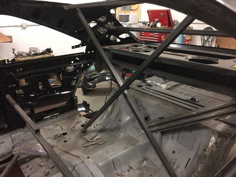

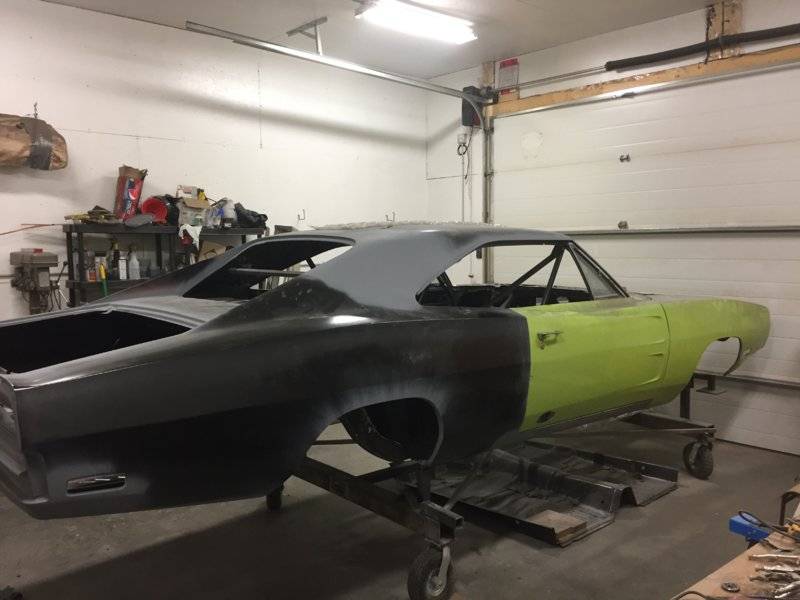

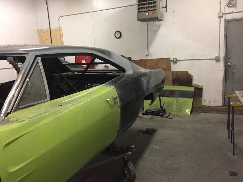

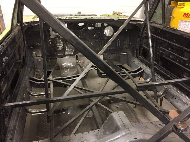

I’m building a 70 Charger. I replaced the whole back half with new AMD panels.I braced the whole car really well.I replaced the roof skin quarters all of it.The stuff lined up ok.The most important part is the bracing and DO NOT USE A ROTTISSERY.It will Bend over a short amount of time.My buddies A BODY is bent.Permenantely.
2514583F-9838-4FA1-ACEB-469EC91D8F92.jpeg 3307A3B1-EBA2-4138-A515-4E8F3C08FB8A.jpeg 4351CDC8-EF27-46E1-9F54-7903A5F75162.jpeg 301F0D88-2AB5-4D36-B28D-309DEE8AB0DE.jpeg

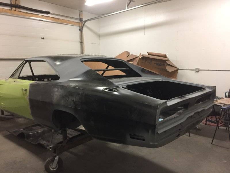

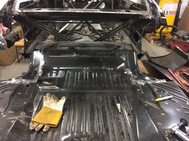

View attachment 599252 I agree with everybody saying the Donor fits better.I used a factory cowl, used AMD COWL to splice in the new sections.I used factory kick panels and door jamb pillars to repair my car where these worm holes of rust developed.I find the AMD **** is good to make the factory **** off the donor less painstaking to repair then put on.The main adavnatage for me now is No Rust and thicker steel skins.I replaced my roof skin when it was good on the back side of the roof structure.The side under the headliner was scaley heavy corrosion.I couldn’t see the skin well enough through the structure.Replacing the skin set me back 1 year.It was worth it though because the roof structure was cleaned up pOR15 and now it won’t rust ever.
