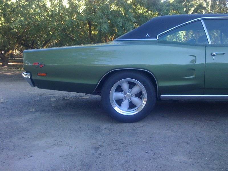

American racing wheels question ..is this a good deal? Will they fit ?

The original pic are Torq Thrust D's. 15x7 only come with 3.76 BS, 15x10 only comes with 3.77 BS.
Slightly different wheels, I have a/r 15x8 with 255/70/R15 on all 4 corners with plenty of room on my 74 Charger.
I have a pair of 15x10 torque thrusts, one piece. They came off a Chevy pickup truck, and that's about all they will fit. Not near enough backspace. (Wanna say 3 1/2-3 3/4, 200 miles away, can't check). Those rears look to be the same casting.
But! 72 charger has huge open, full round wheelwells. If those tens fit anything, I think a gen 3 charger has as good a chance as any. The sevens will be fine on the front. A 8 or 8 1/2 with 4.5 b.s. will fit MUCH better on the back.... but you may have to go to a two piece tt2 to get it.
