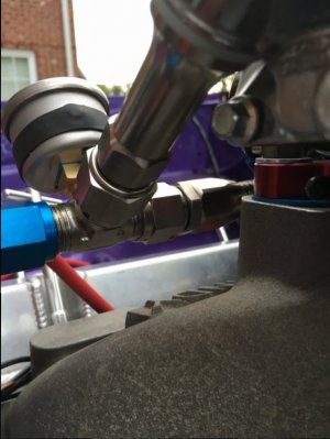

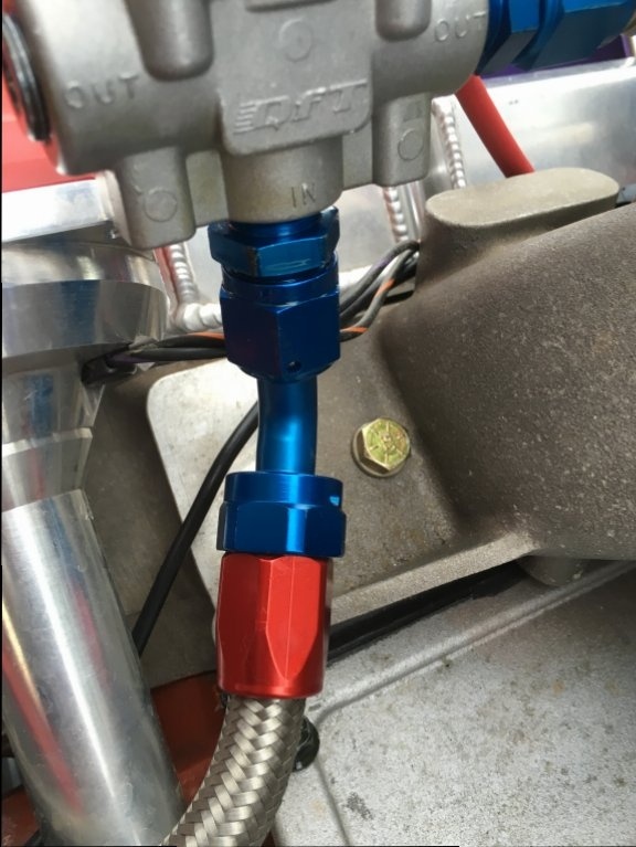

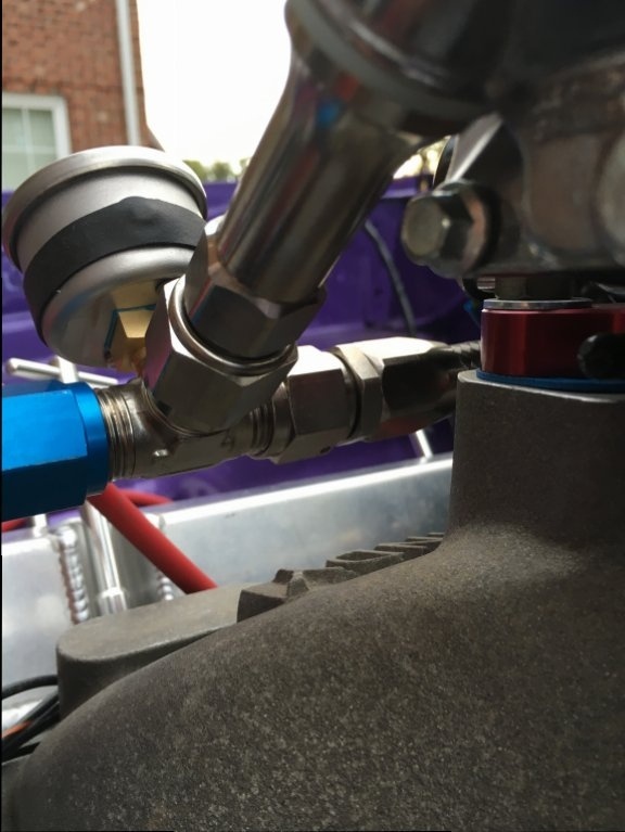

Im wondering if there's something I can use or doing wrong that's causing a couple of my fittings to leak around my regulator. It appears to be leaking where the two come together. Ive got them cranked down fairly tight But they're still dripping every couple seconds image.jpeg

Looks like your fittings have bottomed out. Not enough hose extending thru fittings.
If the seat does not align with ease before tightening the nut you are asking the nut to do something it was not designed to do.
Look at the seat for even contact marking.
Wrap the braided hose ends with electrical tape before installing the fittings.
Sandbug has some good info. Gasoila is a good product. A small amount of lube on the threads is a good idea especially with aluminum fittings.
Agree--When making up --AN fittings to hoses-- I use Parker o Ring lube.
A touch of it on the threads and seat is good assurance.
I have dealt extensively with this in the Aerospace industry. This is one area where German torque specs do NOT apply ("Gutenticht"). The MOST common failure we see is cracks in the seat of the female fitting, and almost always due to OVERtorquing. There are 2 different torque values: wet and dry. If you torque to the dry value with a wet fitting, you run a very high probability of cracking the seat. If you overtourque it wet or dry, again, same problem. Look up the manufacturers specs and use them to a tee. This is critical, regardless of brand.
In the mean time, pull the hoses and use a good light and magnifying glass to examine the female fitting mating surface.

If your fittings are leaking, then put a conical washer on them. If a conical don't cure your issue, then replace the fitting. I've never used anything on AN fittings to help seal except a conical washer, but only had to use them a few times. AN fittings are made so no need to put anything on the matting surface. Just my experience from working on military and civilian airplanes

I took the advice to lube the fittings and that seemed to work. Took a couple tries and I showered all the connections in lube to try and remove anything trapped between the threads. They are no longer leaking from the AN connections but the npt ends that go into the regulator they are leaking. from my understanding I could put a sealant rated for fuel on them? The NPT ends spun on with ease Til about half way then I wrenched them a few more turns.
