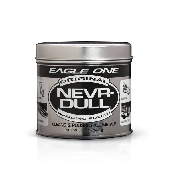

Yes there is a product I found but the name escapes me right now. Smells like kerosene and has little cotton-ball like pads in it. Works great for cleaning and then I simply use car polish/wax over top. I will go out to the garage and look in a while and post.
NevrDul in a can at
auto parts stores.
We used an aircraft spec. version of this in warbird restorations.
I do not remember the chemical company name and in our use we bought in 55 gal. drums. On polished alum. skins the aircraft would usually remain spotless for 2 years (assuming the owner was vigilant in keeping airshow attendees from pawing and hand printing their eyes apple).

NevrDul in a can at
auto parts stores.
Yep, that's it ... $6 at Walmart
