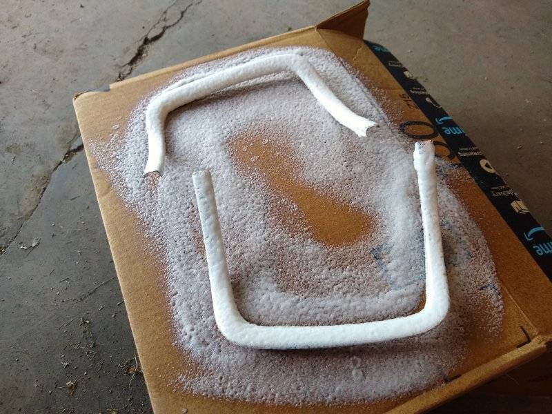

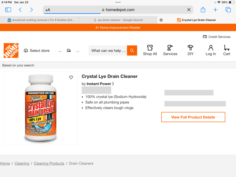

Easy Off is a real pain and can damage aluminum pretty seriously. What I’ve been using is Lye for cleaning drains, etc. It works quickly (20-30 minutes). You need a pan to soak the part in. A pvc tube works fine for long trim or possibly a 5 gallon bucket. I have a sheet metal pan about 4’x1’x6” for some pieces. I use 12 - 16 teaspoons of lye per gallon of water, typically 12. Don’t leave the parts in too long, even some light anodizing still showing is not typically a problem as it is usually so degraded that it sands right off. Typically, after washing you have a smooth surface while Easy Off will erode, pit and scar up the surface in worse cases to where you have to start sanding with 120 or 180 sometimes. Depending on the amount it can be flushed as essentially it’s drain cleaner.

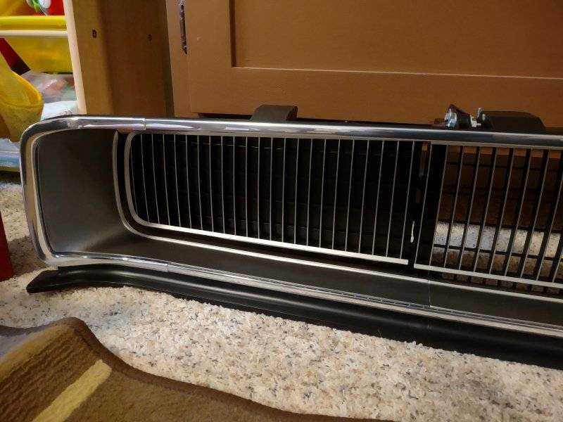

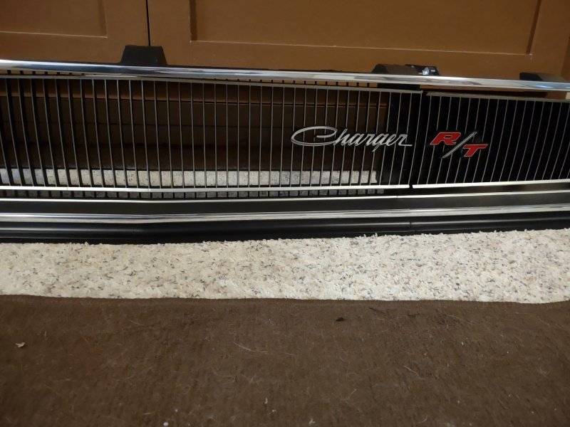

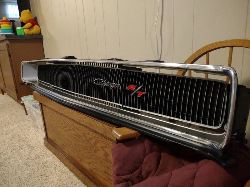

I used Easy Off for the grill trim on my '68 Charger. I cleaned it up with a Scotch Brite and then sent it out with the rest of the trim and had it polished
