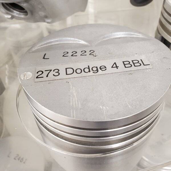

If anyone is still interested, I can check at work to see what we have in stock of the 4bbl hi compression pistons.
