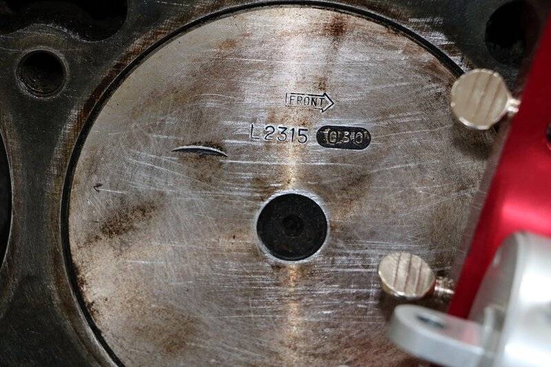

'66 383 block cleaned, sonic tested, bored .030, mains align honed, deck cut to zero with SpeedPro 2315's and stock rods.

1. When I dreamed up this mess, I was sure I would run into valve to piston clearance issues. Using a Fel Pro blue head gasket (.039 compressed), I clayed the pistons and got +/- .110 I, .125 E clearance. Did it three times because I couldn't believe it. Came out the same every time. I know there are better ways to measure, and I intend to try it later today, but I thought the clearances would be much tighter. I was all ready to take the Isky tool to it. Could it be I might actually get away without eyebrowing the pistons?
One other issue that I found was when I installed the pistons and rotated them up to deck height, they seem slightly cocked in the bore....by my measurements with a dial indicator...the side of the piston closest to the front of the motor is level with deck height. The side towards the back of the motor is .005 over deck height.
Considering I only have .039 clearance with the Felpro gasket, am I going to run into piston/head clearance problems when the motor heats up? Should I maybe go with Cometics at .050 to make sure, yet still keep the quench I was looking for?
I would appreciate any and all comments, positive, negative or otherwise, including on my combo. You can call me an asshole if you want...but you gotta get in line like everyone else. At least you'll get to meet my wife and kids there, so there's that...
Your piston to head clearance is just fine. The normal rule of thumb is 0.035" for iron rids and 0.045" for aluminum rods.
Your valve to piston clearance sounds like I would expect from my past experience with TRW/SP piston builds with a cam of that size. The only thing I would have done different is use the Crane or Isky ductile iron rocker arms and not the oil thru lifters/pushrods and those rockers.
Sounds like a pretty good build overall, should be reliable to 6,500 RPM with a 6 quart or more oil pan.
Your piston to valve is fine, I've run much less on 7000 RPM motor. The piston to head is fine with the .039 head gasket. The big valve, ported 516's should work well with that cam. Did you "eyebrow" the top of the cylinder bores to help the flow?
If I read your post right you pistons are cocked in line with the piston pin?
If they are something is wrong.
The con rod is bent or the piston pin hole has been honed crooked or something like that.
If the motor runs and the piston is cocked over 5 thou it will wear very quickly.
Or the pressure will burn up the big end bearing in no time.
Measuring deck height can be calculated two ways. Rock the piston both ways and average the measurement. Or measure directly in the middle of the piston. Method two is not always possible.
Doug
Looks like a pretty good result... Piston to head is fine, and if your numbers are right (And since you've double check I'm sure they are) your piston to valve clearance is fine as well... Should be a stout 383... Have Fun!!
as Steve340 mentioned, I would double check the piston "tilt". Is it a mirage? Is it real? Are all the pistons that way or is it just one/two? It seems unlikely, but it is "possible"
Your combo looks like a good one, motor and otherwise. If you're driving aggressively and not doing too much highway driving, you will love that 3.91/stall combo
