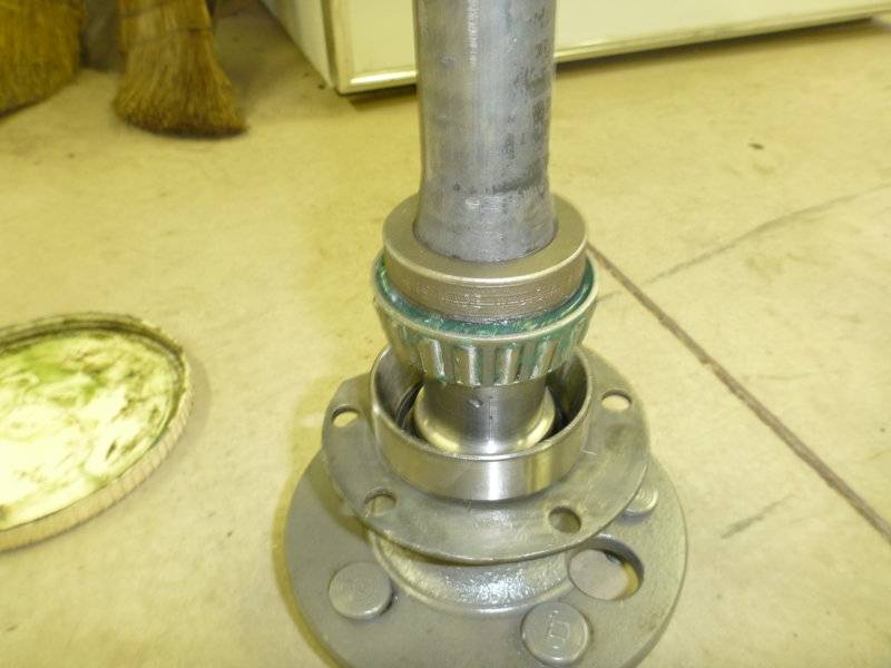

Looks like oem bearings to me but why is that ring laying on the bearing! Is it a o-ring or a metal ring? And without the thrust pin things will not work very well for long.
Its a metal ring click on picture to expand , not a good picture nothing loose bearings are good . . I'm not moving forward until issue is solved . I'm going to order thrust pins and see what happens
That thingy shouldn’t be there on the bearings.
When you install the thrust pins back the adjuster way off since to have zero end play on the passenger axle you've cranked the adjuster in allot further than it needs to be when thrust from the drivers side axle is transferred through the thrust pins....
Get a better shot of the metal ring... It may be a garter spring from the inner axle seal...
I had to stare at it and then grabbed my assembly picture to convince my brain..... normal once you give it some thought. As noted elsewhere, you can't set play without the thrust button in the pot assembly.

That thingy is part of the bearing. Their on both bearings
Yeah, thats what I'm thinking... I don't see what folks are talking about, I think whats being talked about is actually a dark ring on the bearing lock ring....
The round bar thingy is the part of the cage for the rollers. Took me a while to figure it out. But it sure does stick out quite a ways.
Ring isn't laying on the bearing , its the top part of the roller cage both bearings are the same.
I looked at it real close doesn't seem to bother anything ,as I've said both sides are that way must be the brand or type of bearing.
Just sticks out further than what I’m used to seeing, that’s why it caught my attention.
Looking at the pic on my phone made it look different vs looking at it on my desktop! lol
