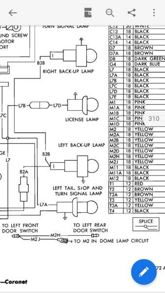

Looking at the diagram for my 67 shows the ground coming off of the socket itself on the left socket. I suspect your housing is not grounded well since you just did a paint job on it...
