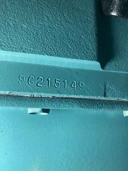

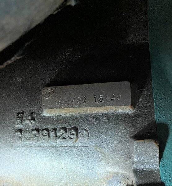

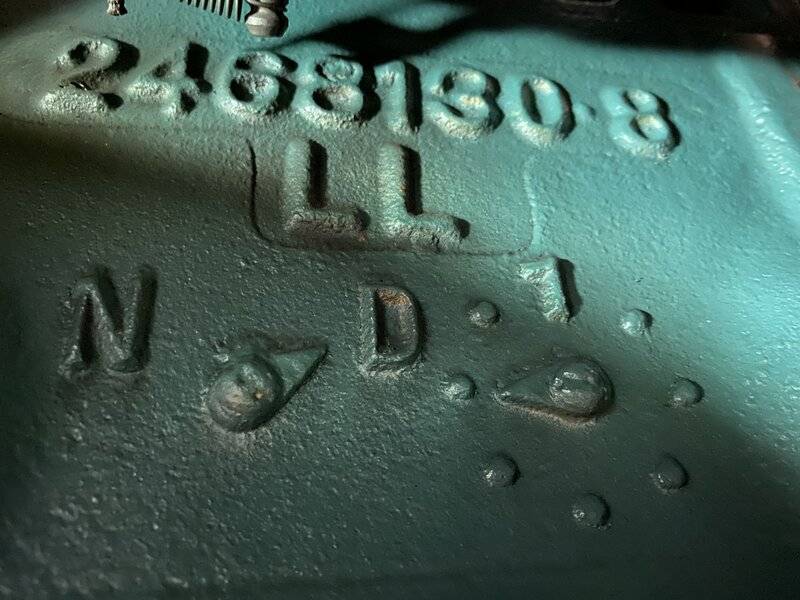

The Good: Engine and Trans in excellent condition, rebuilt, and I verified original to the car per the pics. Brake system all good. Dash gauges restored. Front grill, bumper, headlight and taillight bezels and trim all in very good condition.

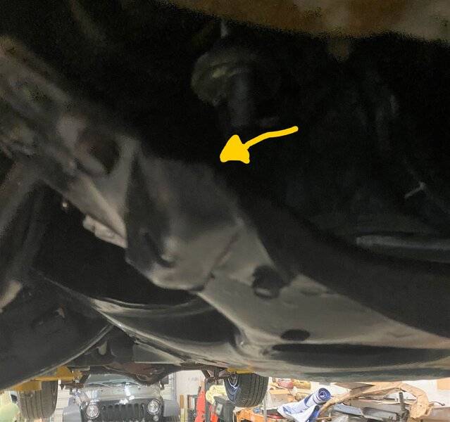

Question: per the pic of the K frame, on the front of the frame on each side there is some metal bolted to the frame but appears broken off on each side - what is this?

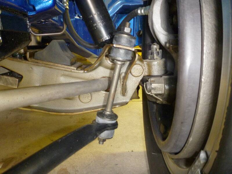

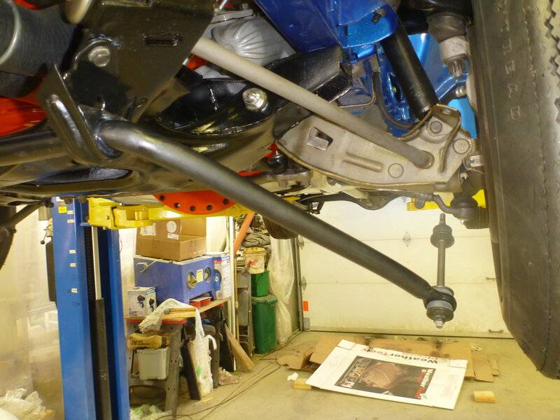

Possibly remains of sway bar brackets. Does your lower control arms have sway bar tabs?
No, should be factory... looks like someone cut the rubber bushing retainer straps off and left the base plate.

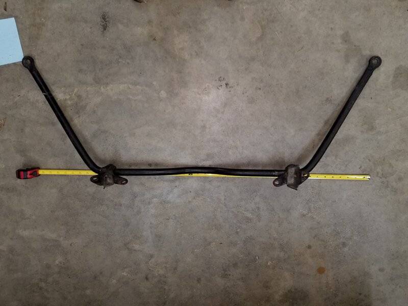

66-69 sway bar brackets bolt to the front of the K frame from the factory. There are also aftermarket ones that do too. I don't have a a great picture of one, but here's the best I can do on a sway bar.
