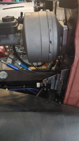

Hi all,
Wanted to see if anyone has installed a similar kit to mine and ran into this issue;
I got a full power disc conversion kit for my 66 Coronet; rotors, spindles, calipers, etc; all that went on really nice, fit well.
Now I'm working on the brake booster. The linkage for the booster rod to the pedal is going to hit the firewall if I attempt to install it.
There are no instructions with the kit, and the few I found online mention cutting the booster rod, which I did, about a 1/4 inch. It will still just barely hit the firewall, and I don't really want to cut it any shorter without some direction.
Also, there were 8 spacers included in the kit with the booster. With no instructions I can only assume these go between the booster and bracket, but I don't necessarily like that;
Anyone ran into this one or have any ideas? See pics!

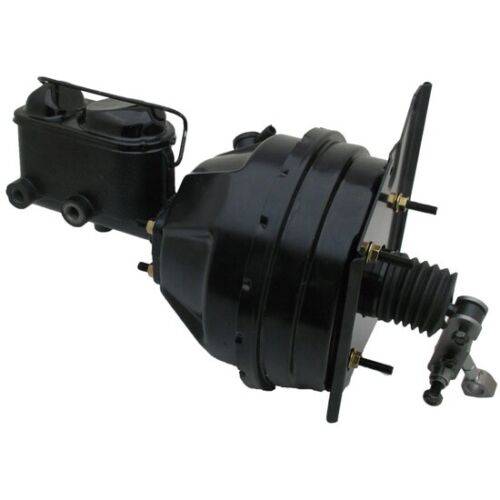

I ordered up this Mopar style booster, includes factory style linkage and firewall plate. Its from someone I have dealt with before who knows their stuff. Looks pretty straight forward so there shouldn't be any questions on this. Also ordered brake lines and prop valve from Doctor Diff -- never used them but have heard alot of good about them. They were able to set me up with factory style lines and a prop valve too.
Maybe someone else can use this booster/master I'm stuck with on some other project. Looks good enough, just not a big fan of the booster-firewall bracket with linkage provided. Too complicated and funky. I don't like to mess around when it comes to brakes. Master and booster itself is perfectly fine. All that being said this will be the first, and last time I buy one of these "kits".

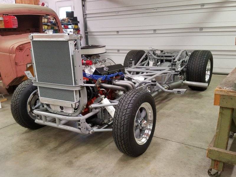

Here's a pic of the chassis and the sheet metal installed on top of it.

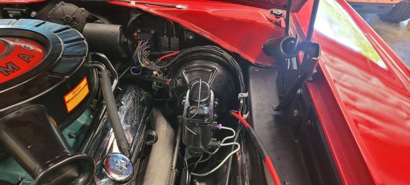

Got the new OE style brake booster mounted up today with the new power brake firewall plate; wasn't to terribly difficult.
My brake pedal now sits about 5" off of the floor. Scratched my head for a minute but this is correct apparently for the Bendix power brakes, they don't need nearly the travel that the manual brakes did so the pedal sits lower. I've searched the forums a bit here and it seems some have modified the push rod to get the height closer to the clutch pedal, but I'm going to see how I like it first.
