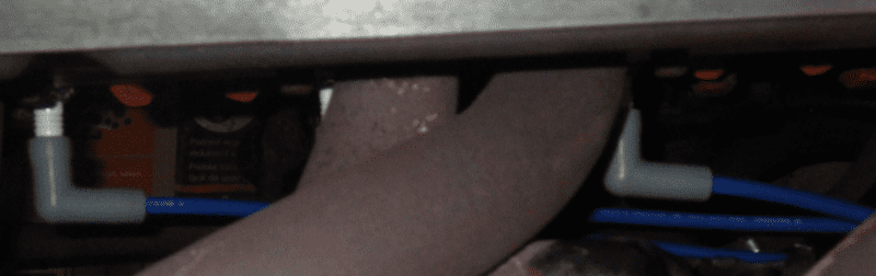

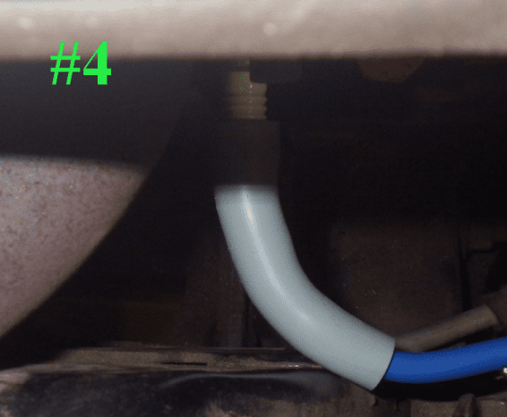

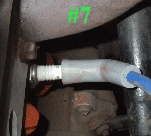

Lol, I feel your pain. On my abody 7 runs into the steering shaft 4 & 6 run into the control arm bracket/inner fender. Waiting on 90° ends from the supplier, like I ordered in the first place...........
#7 not even close to being on. It would clear otherwise. On my wedge all boots come to within quarter inch of metal body of plug. You want PIA? Put together hemi wires, plug ends.

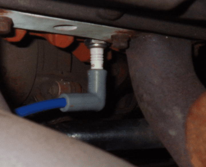

Supplier sent me 90° plug boots.
Lol, Liken' 'em more better! :)
#4 & #8 visible..........
# 7....................
