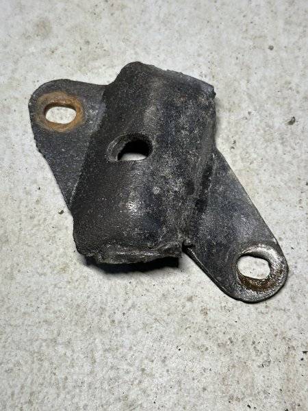

I have a new sway bar and kit coming from Summit per recommendations from others here, much appreciated.

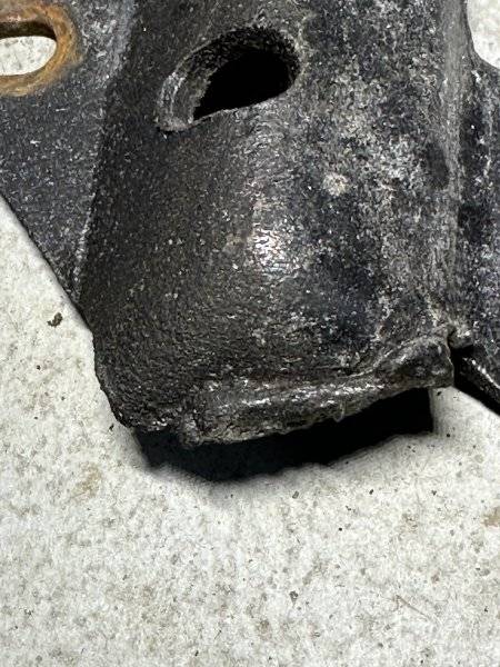

In getting ready to install when it arrives I removed these brackets from k frame to clean up, blast, repaint etc. They look mangled on the ends and it appears there may have been hole tabs for the sway bar bracket to connect to?
Also, I’ve noticed the LCA on the drivers side has a tab but appears bent upward. On the passenger side it appears to have been torn off completely.
Thoughts, advice, direction? Thanks much!
If you bought a swaybar kit it should come with the brackets. What you have there is a factory mounting bracket with half of it missing. The brackets in the kit won't look like that, but will work just fine.
Whew! Good to know. Thanks much.

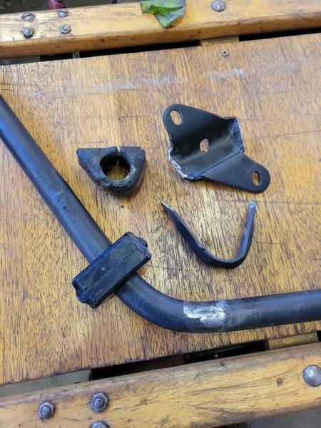

The bushings can be replaced without cutting the brackets apart like that…
I've done these poly ones before without cutting, but this time I had to correct bent brackets and found cutting to be a more streamlined approach. Clamping them together for welding was a bit of a PITA though
