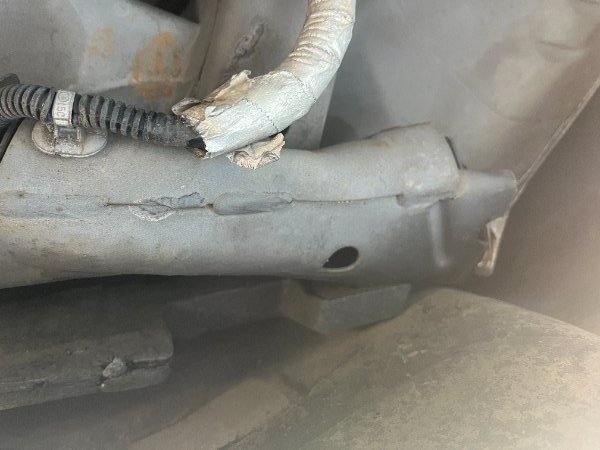

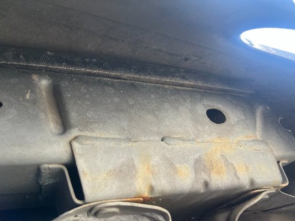

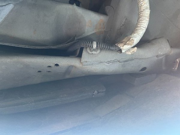

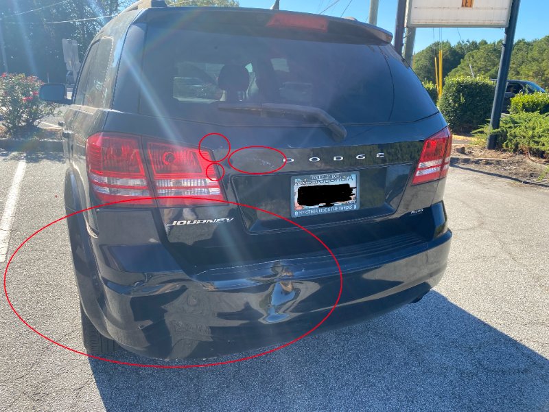

My son got rear ended in my wifes car. It looks superficial from the outside. Bumper cover, cracked tail light and some cracks in the hatch door. I think its aluminum but I might be wrong. The major issue is the structure behind the bumper. One side "the side that wasnt hit" is like 4 inches thick. The driver side is smashed down to nearly 2 inches and raised about the same. The car just turned over 80k miles. Its a 2016 Dodge Journey not top of the line but the 4cyl model. Question is i guess is it possible that the structural damage might cause it to get totalled?
Passenger side inner bumper.
Driver side inner structure.

I had an uncle that was a bodyman and he made his living for many years fixing totals and then selling them. With his help I bought several totals from the insurance auctions over the years for my vehicles and for my kids first cars. First is how do you want to fix the damage? all new OEM parts, aftermarket parts, or good used parts? My uncle used to kind of specialize in a certain type of car and buy up as many as he could, so he always had plenty of cheap parts. From your pictures I don't see an issue fixing this vehicle especially with good used parts. But again, I did all my own work. and I might add never had an issue with fixing a total from safety or performance, saved me plenty for a lot of years.

A "total loss" is an economic term. It simply means the cost of repairs is at a point where it's at the value of the vehicle minus it's salvage value. An older vehicle with superficial damage, such as a bumper, fender and hood may be a "total" since the cost of the repairs exceeds the low retail value of the car. A newer vehicle may have structural damage, including requiring replacement of a sidemember, but it would not be a "total" since the vehicle value is much higher than the cost of repair.
On your pix: from what I see, your plastic bumper cover may require replacement, although I've surprised myself in repairing covers that looked worse. Inside, you have a foam absorber which if broken, requires replacement. The metal bumper reinforcement is a bolt-on part,mangled and requires replacement. The rear x-member and side rail are probably high-strength steel but appear repairable. Pix are not clear as an on-sight eyeball evaluation.
Yea I am still dealing with the insurance company so I didn't want to take it apart yet to see the actual damage. I found a rear bumper reinforcement OE used on ebay for 58 bucks and free shipping. So I see that it is a bolt on part so thats good. From under the car you cant see that it bolts on so I thought it might have been frame damage. But I see what you mean.

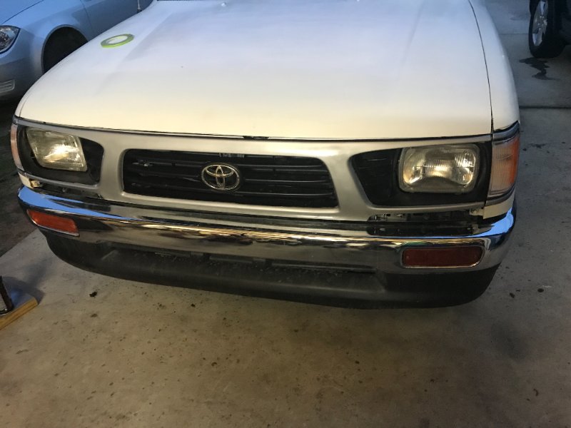

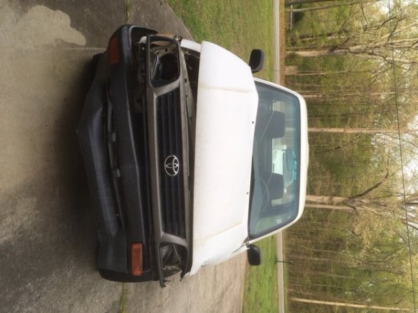

I have fixed several vehicles in the past 20 years living here. Here is a bashed up Tacoma I repaired.

Could be the light and photo but the lower rear corner of the qt looks damaged also. 1st glance that looks like a $4,500 to $5,000 job.

Doesn’t look totaled to me but as WileE said it’s basically an economic issue - value of car vs repair.
If the quarter and the frame are damaged, it'll be totaled. The book value is probably not very high on that model and of course, they will scrounge up some used parts, if possible, for any repairs. If the repairs are $4-5K, they'll total it.

I can only see so far behind the impact bar until I take it apart. But it looks like the quarter panel is ok. Its just the impact bar and what it is directly attached to that I don't know.
