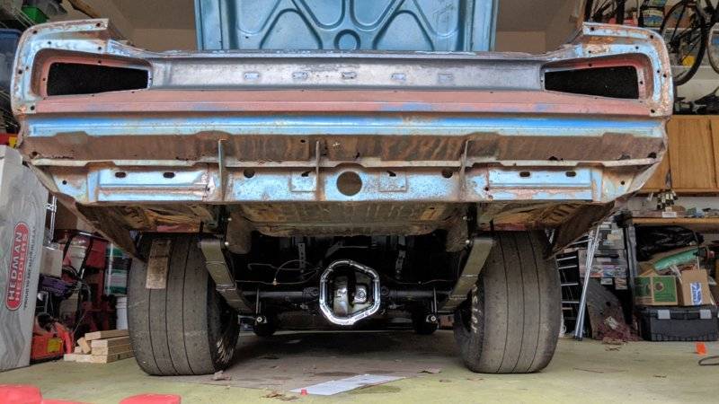

It's time to tackle the *** end of this thing, and I'm thinking I can repair my tail panel but it almost certainly has to come off to do so. Plus the trunk pans are shot which is another good reason. Wanted to see if anyone has had a problem with the body racking with the tail panel and trunk pans out, or any suggestions about how to brace it to avoid any issues.

I wouldn't think you would have a problem. When reinstalling panels attach with sheet metal screws and check fit before doing any welding.
Have car sitting on wheels and try to make it as level as possible. That might be having wheels and tires all the same size.
I have a 68 coronet. I replaced the right quarter panel, tail panel, left side trunk floor, and left extension. I bought most of it through amd. Mo-par city shipped me the whole *** end off a 68 for the tail panel. I didn't support anything while it was all apart. Though i was very cautious, working around the quarter, with it just hanging there. Surprisingly everything fit well. Even the deck lid has decent spacing.

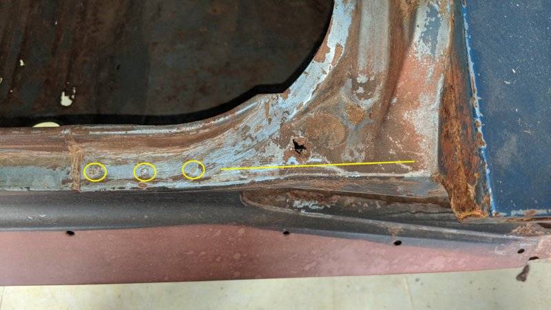

One other question, I assume there are spot welds all along the top edge of the tail panel where it meets the trunk corner?
I highlighted a few I could make out. Of course getting a flap wheel after it would probably make them show up
better, but always nice to know where to look as opposed to continually trying to pry it apart.

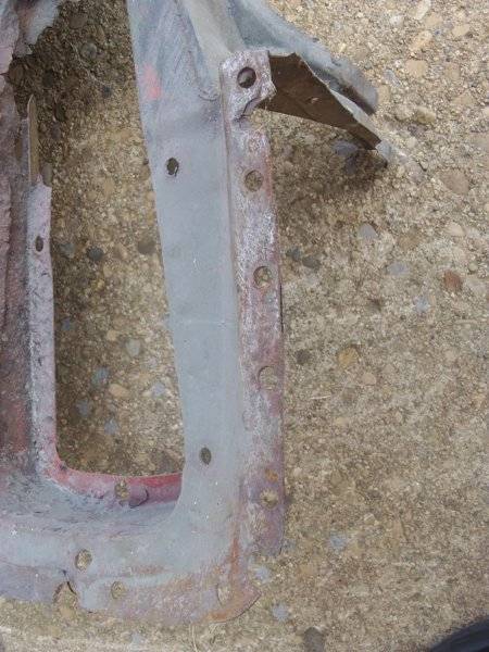

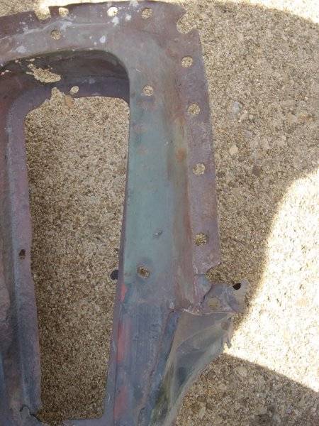

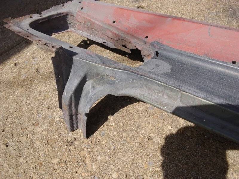

I've got a tail panel, thats been completely separated, with the welds drilled out. I could post a pic if you like, but thats no guarantee yours are in the same place.

What i have, wasn't taken apart at the places you have circled
