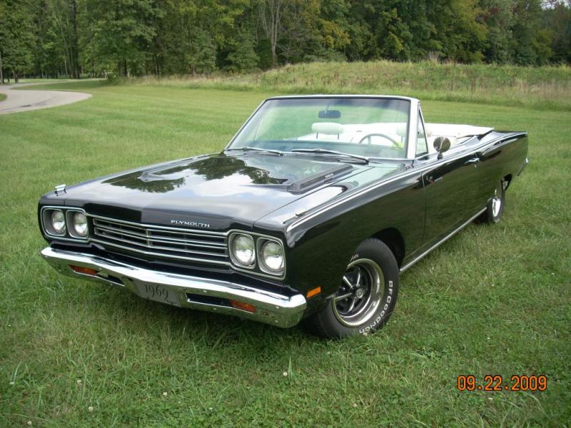

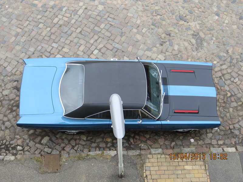

If it has an N96 Air Grabber Hood the vents/grills are on the top on a 1969 & will be red colored, if no Air Grabber option the are Black & fixed... NO N96 Air Grabber option in 1968, the blocked off scoops are pointed out to the sides, with engine size call outs badges... Both have engine size call out on the sides of the hood scoop &/or bulges, whether it's an Air Grabber style hood or not.... Also I believe both the hoods & latches are interchangeable, other than design... there is a different style ends on the radiator core/grill support also, to have the hood pins on the 69's too.... I also think the real early 69's a few of them got 68 style hoods, until the, type with the grills/inserts on-top came out, I could be totally wrong, but I seem to remember that little ditty, being told to me years ago, I've had/owned 13 of the 68-69's now.... The hoods the same it's the inserts/style/scoops & grills or N96 options, that are different...
