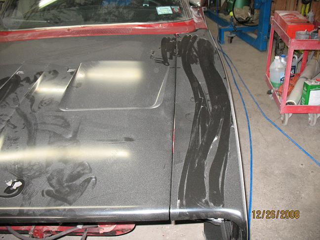

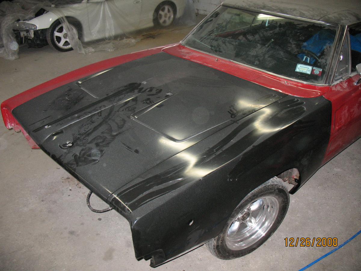

my 68 charger got punched in the nose last year. I used an AMD drivers fender and hood. The hood required some filler to get it perfectly flat and smooth, but it fits very well. The fender was perfect in every way.
