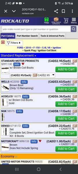

A newer vehicle coil pack ignition boot might work

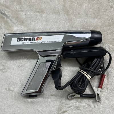

I just recycled my old timing light, and bought a new one. So sorry, you are too late. But I do like the new unit, that has a clip to go over the plug wyre. Test yours, it may be like mine and not work.
Here is a good idea... Use your old one as parts or use this one to fix yours.

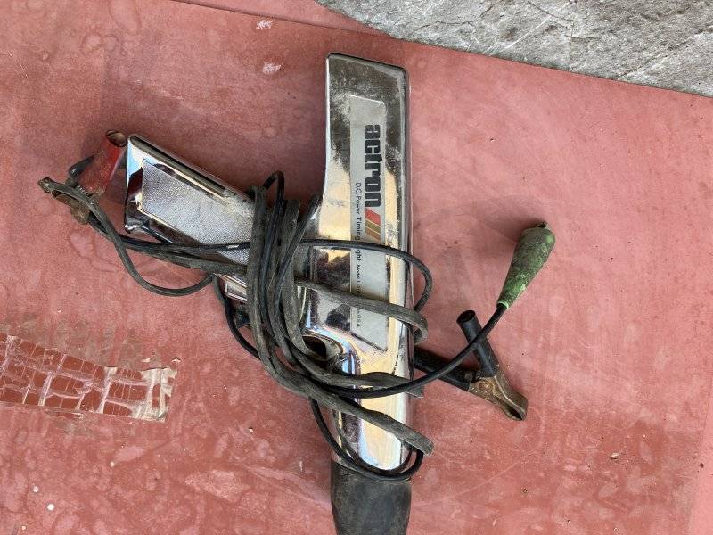

I still have that style timing light. Gotta be 55 or so years old.
