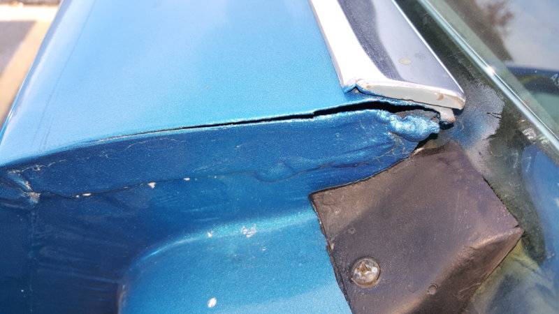

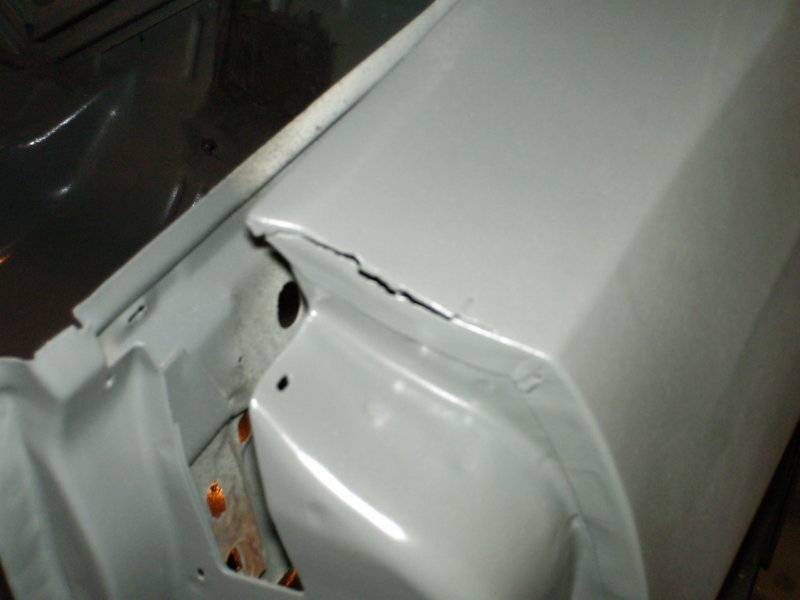

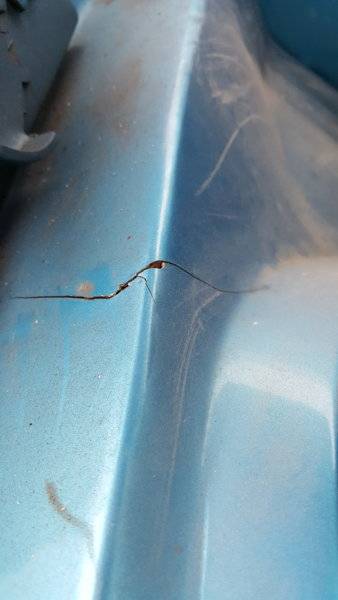

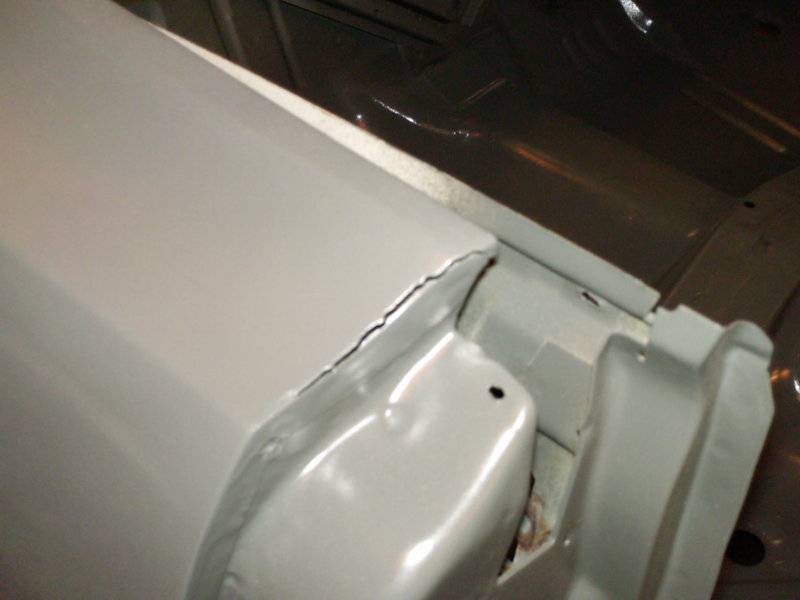

I have attached a few pictures of some weird stuff I found on my 69 Charger
First, under the hood, there is a crack line in the metal on the wheel hump under the hood
Second, it is kind of opening up right by the back seat glass edge, when you open the door
Both are on the passenger side.
Could this be from drag racing? It has a build 440 in it. I wonder if it was too much power for the body.
I heard they used torque boxes on hemi cars only until 1971 then they were used on 440 cars that help to keep the power form flexing the unibody frame. I have reason to think that maybe the car had been hit in the back long, long, long ago but I am perplexed by these 2 things. Anyone seen something like this before?
thanks!

Body flex and/or rust on the inside. Open the trunk and look way up in the quarters with a flashlight...I have to think if it was from being hit the cracks would have happened long ago

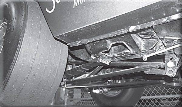

This is the box they added for the Hemi. The traction arm shown is not a factory stock item.

If it was raced, with a big block, then it is most likely from stress...Torque boxes won't stop all the flex especially in a racing application. If the car in the black and white picture, is your car, it looks like it was a pretty serious race car...

No, mine doesn't have the box, I found that pic on line to explain what I mean

That's called massive torque in one of the original uni-body designs. Pretty common problem actually.

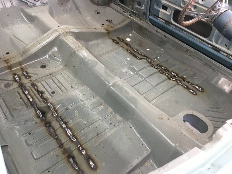

Weld in a set of frame rail connectors from US Car Tools then weld in some additional reinforcement behind the panels where they cracked.

Unibody cars that were not reinforced with aftermarket parts were prone to body flex and cracking the joints. If the car was sub-par from the factory, then it was even worse but if you think Mopars were bad for that, then you never owned any Fords....

That first photo is a Bondo crack. Look at how they smoothed over the shock tower to apron. Hiding old issues....
Look for collision damage, like a buckle right ahead the the k frame. B bodies don't bend or crack at that spot without some rough treatment.
The door jamb crack is super common on 68-70 B body hardtops
Had that crack by the door in a 318 Coronet. Certainly not caused by HP. Just another weak spot.
Agreed, the inner fender just looks like filler cracking. Anytime you put filler on thick or over poorly prepped surfaces this is what happens.
Agree. However who is to say that the shitty body work wasn't cracked on the inner fender by torque as well.
The door jamb crack on the quarter is definitely torque.

Unibody was a new term that came out when they figured out they could save more money making cars. You never saw those cracks on full frame cars. I have an Ebody that is cracked at the rear quarter panel and the roof seam. I had reinforcement done after the crack began.
I thought the quarter panel crack looked like bondo as well.
This crack is pretty common on Chargers. On the cars I've had over the years, mine have all been on the driver's side. The fenderwell crack is a new one on me.
