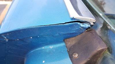

Any ideas what may cause torn inner fender well, popping by back door
That's called massive torque in one of the original uni-body designs. Pretty common problem actually.

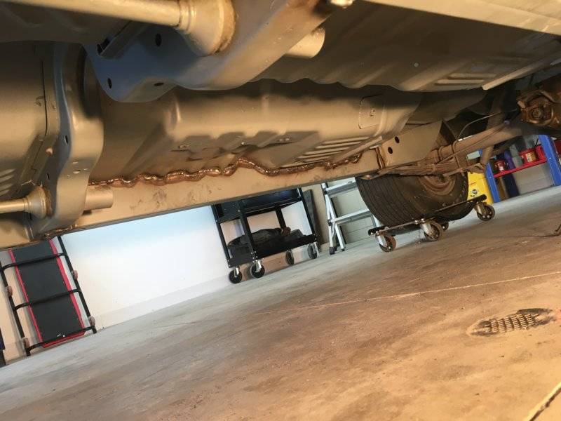

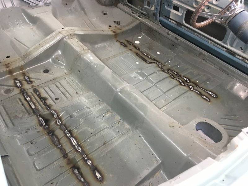

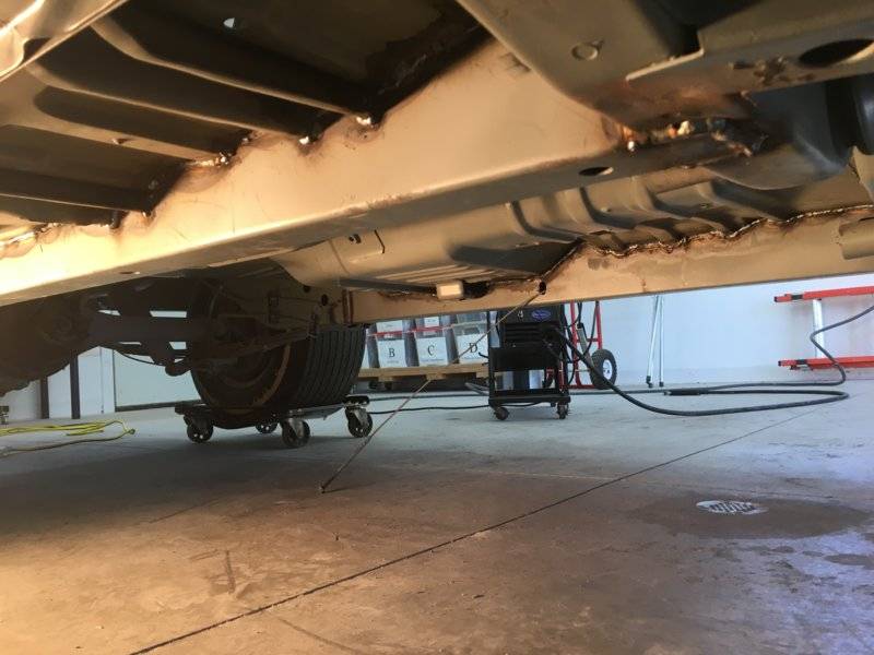

Weld in a set of frame rail connectors from US Car Tools then weld in some additional reinforcement behind the panels where they cracked.

View attachment 692309 View attachment 692310 View attachment 692311

This crack is pretty common on Chargers. On the cars I've had over the years, mine have all been on the driver's side. The fenderwell crack is a new one on me.
OK, I think I got the picture now
The fender well crack does indeed seem to be a thin layer of bondo. It looks like in a past life a very old repair was done

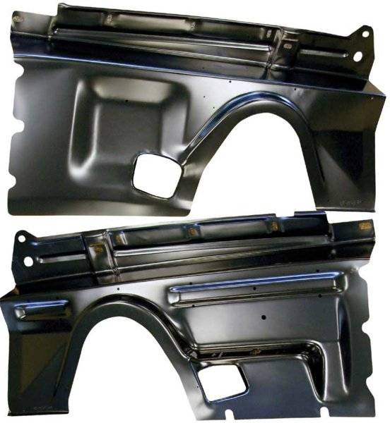

http://www.autometaldirect.com/1967...dy-front-inner-fender---pair-md-38-p-436.html
I jacked the car up and did a long study of both sides of the car to compare them, and how they have been attached/ welded. It seems like a replacement inner fender part it was put on decent, but my guess is they wanted to smooth out some imperfections. Based on the colors and patina, it looks like it was done long ago. Frame rails look fine, straight, etc but we will see when we take it in after our front end rebuild is finished, but a few older smart car guys have put it up on jack stands and looked it over, seems they all think it's good
