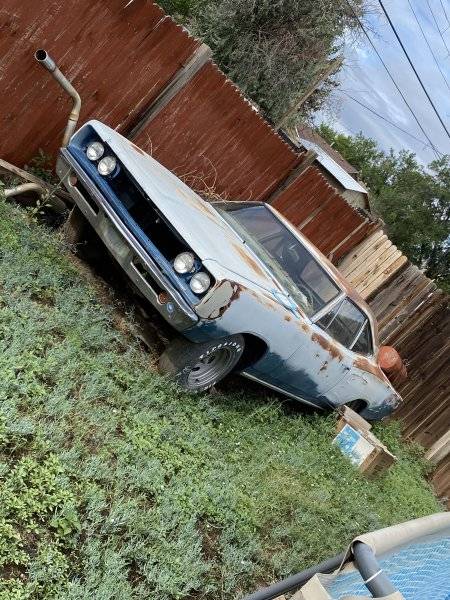

I have a question if any one can answer I have a 68 coronet with a 273 will the small block k member work with a big block? Also looking for a 4 speed big block bellhousing for it
I have a question if any one can answer I have a 68 coronet with a 273 will the small block k member work with a big block? Also looking for a 4 speed big block bellhousing for itView attachment 1452772
68 k member is the same for big block and small block v8's unless it's a hemi. You'll have better luck if you post in the WTB wanted to buy forum for the bell housing but check the For Sale ads first. BTW, nice car!
You should post in the Welcome Wagon forum with a few pics of your coronet. You'll make lots of friends and maybe even find a bellhousing if you're lucky.
Edit: Maybe don't ask about the bellhousing in the welcome wagon forum. Just saw the rules for that forum.
You should familiarize yourself with the different bellhousings used for 130 and 143 teeth flywheels, and different pilot sizes in the housings etc. A true 11" clutch will not fit on a 130 tooth flywheel, and a 10.95" and a 10.5" will not fit on a 143 tooth flywheel. Just make sure all the pieces are compatible before buying them.
Welcome another '68 from NM. Glad you are saving it! Its a can of worms on the mix and match 4 speed parts... They dont mix or match, usually. Tooth count, diameter of flywheel, diameter of bearing housing, pilot bushing, spline count, z-bar length and configuration, shifter location, u-joint, driveshaft length, floor hump cover, pedals... just a few of the variables.
