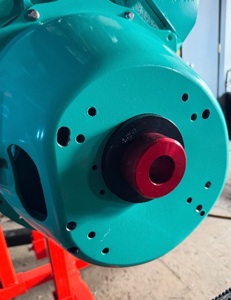

Silver Sport makes a cast aluminum one, I’m in the process of modifying a Lakewood scatter shield to fit, bored the register out to fit, and drilled the mounting holes, the lower bolt on the drivers side is tricky as it hits right on the radius where it starts to “bell” towards the block.

I’m familiar with the aluminum one but would prefer steel. Modding the Lakewood is interesting, it is an a833 bell correct? I was under the impression that the input shafts were different lengths.

Yes it’s an old 833 bell housing.
So from what I have seen online the Ford TKX input shaft length to the face of the case is 7.21", A833 is 8.625", is this what you have also found? If so wont the TKX end up too far outboard?
The QuickTime Bellhousing for a big block to a TKX is 7.270” face to face, the Lakewood is 7.500” and the roller throw out bearing Silver Sport supplies mounts in the torque converter pocket in the crankshaft so it sits further back in relation to the crankshaft.

I’ll mock up the bell housing with the trans and no clutch and get some photos this week. I have to weld in weld nuts for the trans to bell housing bolts, while I'm at it I’m going to add weld nuts for the starter mount and bell housing to block saver bolts as well so I don’t have to deal with nuts if or when I have to dig back into it ( hopefully never)

That would be great. How much did you need to open the bore on the bellhousing? I may be wrong but it seems like possibly just .043"? And if so did you consider just taking a bit off the bearing retainer?

honestly I didn’t measure it, I took it to my friend, Ted at Opel engineering and he set it up on his mill and bored it for me. He did say the original bore was not very round, it is now…. As for machining the bearing retainer I never considered it, because of the hydraulic throw out bearing, and in case I ever need to change the transmission for any reason.

No photos, but I get 1/2” of input shaft penetration in the pilot bearing with the block saver in place.
Is some of that the tapered potion of the input shaft?
