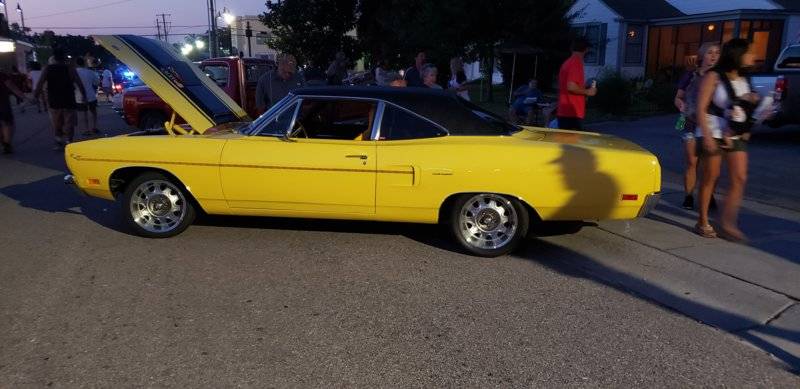

Recent pix

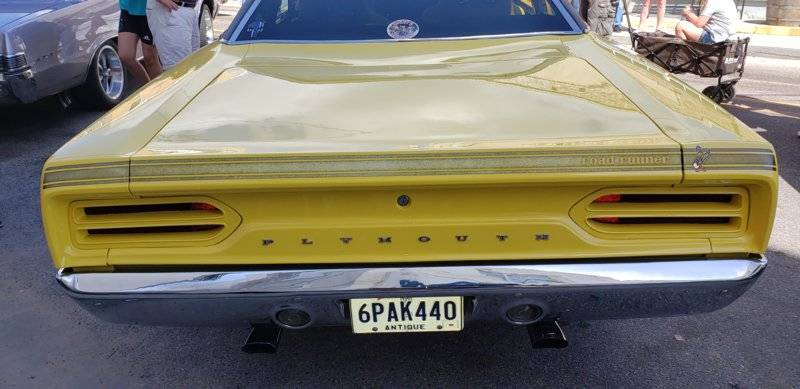

This last pic was to show someone how the black stripe was reflective, and I used my flash.
I'd leave it, looks better than it ever would with a cone on the front. With the exception of builds like Hemirunners I really dislike the the winged cars, they need to be at Nascar ride height to look right to me.
Only thing I'd think about if it were my car was dropping the nose just a touch to get a little rake but that's just me. It's a beauty!
I had just a couple of days to order the front tires for the new wheels I had got. My previous 15" Rallye wheels had tires that rubbed the frame, and I had just missed disaster on my wife's GTO with her front tires..if hers would have been 1/8" taller sidewall, they would have rubbed the wheel opening trim. So I "played it safe" and got some with kinda short (45) sidewalls. The rear tires are 315/35/17s so I didn't want to go too tall up front. I prefer more rake too, but I just had a pair of Viking double adjustable front shocks installed and asked for the front end to be lifted a bit.
Nothing that can't be fixed with time, but I don't have much of that right now.
Thanks.
I'm going to try a taller rear tire on my 9" aluminum Rallye wheels, maybe a 345/40/17 will fit in a drag radial.
My next pair of front tires will have a taller profile on their 8" wide wheels.
