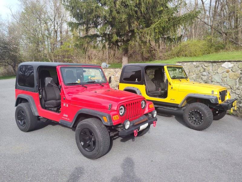

My bone stock TJ is a "poseur"...but it's totally capable (and once I install my $500 worth of front and rear Aussie lockers it'll be a REAL four wheel drive)...

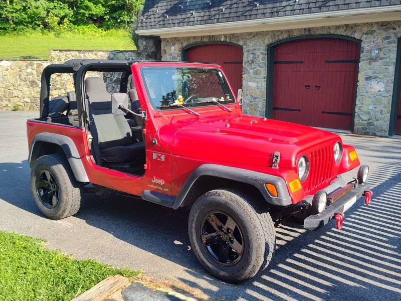

Summer/beach trim

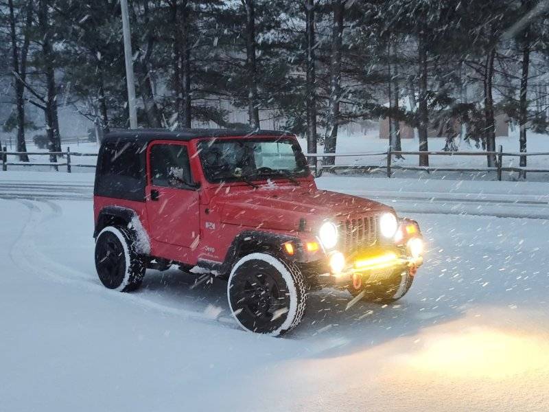

And winter toy
No lift, highway A/S tires, stock drivetrain and exhaust...and still a freakin' blast.
Hers is the yellow one
Small lift and I don't like it. Only about 2-3" (PO put it on). Ride quality is crap compared to OEM springs. Admittedly she has better gears (3.73 compared to my 3.07s) due to hers being a factory 30" tire package...but I much prefer the stock suspension. And, hers has an MBRP exhaust - I like the sound. When mine rusts out....

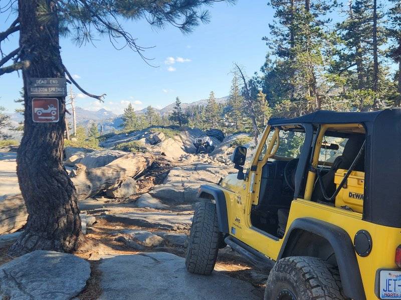

In HS class of 77' Baby
I lived in the town over from the 'Start of the Jeepers Jamboree'
Rubicon Trail
Georgetown Ca. in ElDorado Co., we had a 165 acre ranch in Garden Valley
down the hill off prospectors grade, going towards hwy 193, towards hwy 49
I just about lived on the Rubicon trail, Wentworth Springs
& another place we called "end of pavement"
all that area was our hangout in HS, away from the adults eyes & ears
just before Lake Edison, before you got to the Y, back then dirt rd.s
to go towards Wentworth Springs
the actual beginning of the Jamboree trail...
My dad's Jeep 4wd/4x4 club was the
Georgetown Stump Jumpers, were incharge of the Jamboree for decades...
Mark Smith the org. organizer lived across the street/hwy from us...
We had guys who'd actually purposely leave rigs in just RWD, not lock in the front
& see if the could get past the slab going up to Spider lake or farther even
see would get the farthest...
1st time on it (Rubicon Trail, no signage anywhere back then)
in my dad's all OE like 28" M/S lil tires new 73 CJ5, w a rollcage
made the whole deal easily, half crocked/drunk...
I was hooked after that, at 14...

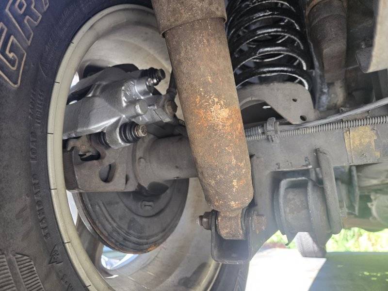

I spent some time and money on the ole ZJ.
The front was pretty basic. Slag hammer the growth off the rotors, so the pads could touch the whole face. C.V. rebuild with new boots, used bearings and flanges off the parts rig, along with the rotor splash shields as mine were 1/2 gone.
The steering linkage, rotors, calipers were all new last year.

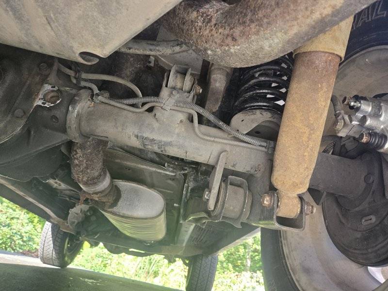

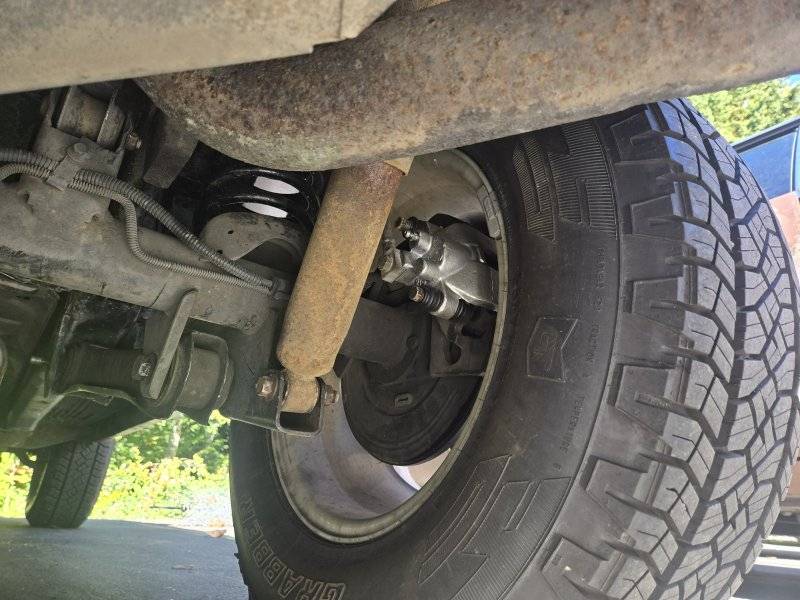

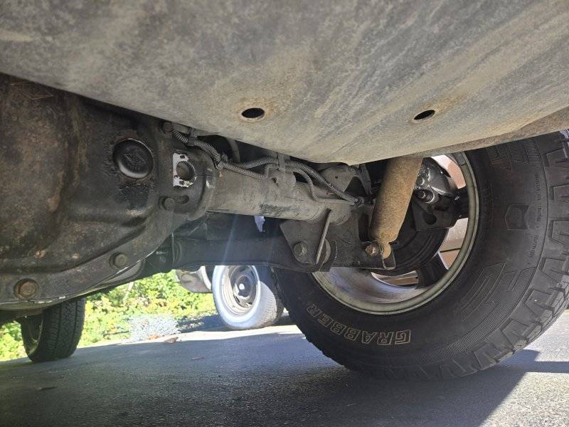

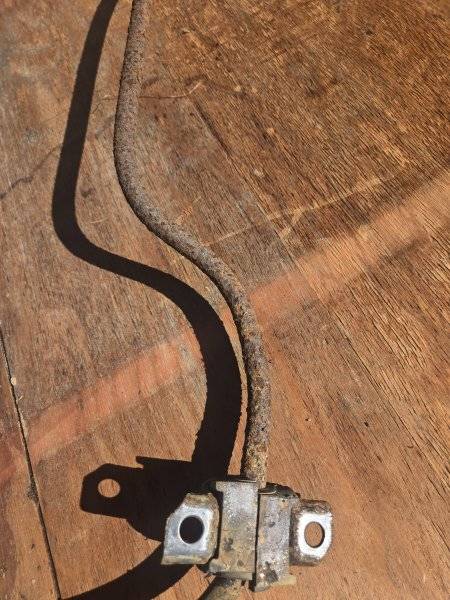

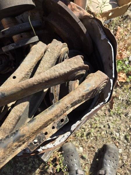

The rear was so bad, that I finally upgraded the rear diff out of necessity.
Control arms, sway bar, springs, rear brakes, well everything, was rusted out.
Put a dana 35 with sure grip in instead of the jeep 7 1/4. New driveshaft, etc.
The shocks were still working great, even though the outer tube had rust holes.

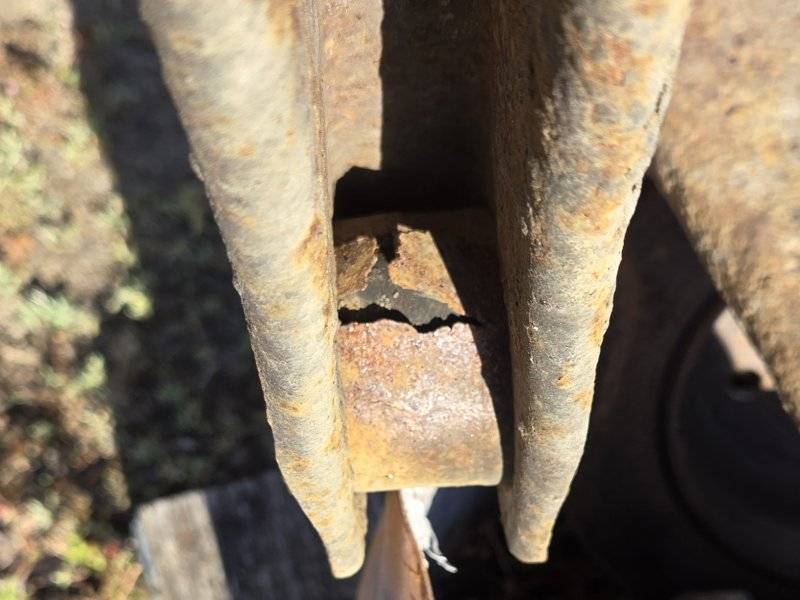

Control arms were delaminating, bushing sleeve was rusted through. That 5.9 parts rig from 10 years ago has provided alot of parts. The new parts only have factory dirt.

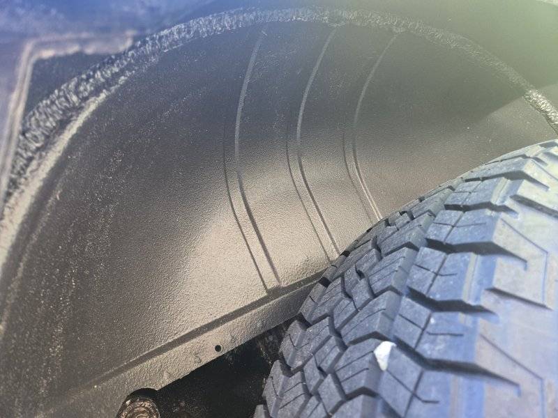

Then, while everything was out of the way, I sprayed rust mort over all the rust. Pressure washed the whole bottom, then undercoated the wheel wells, mostly for sound deading, as they are galvianized and were showing no rust.

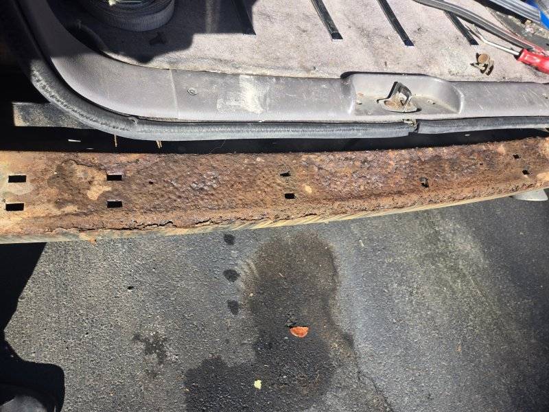

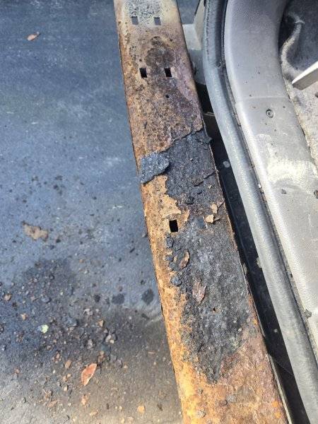

While the rear splash sheilds and bumper cover were off, I chipped the rust off the bumper reinforcement. (It was #2).
Fluid film is here, so everything will get a coat.
The door bottoms are bad, rockers are too, so death is inevitable

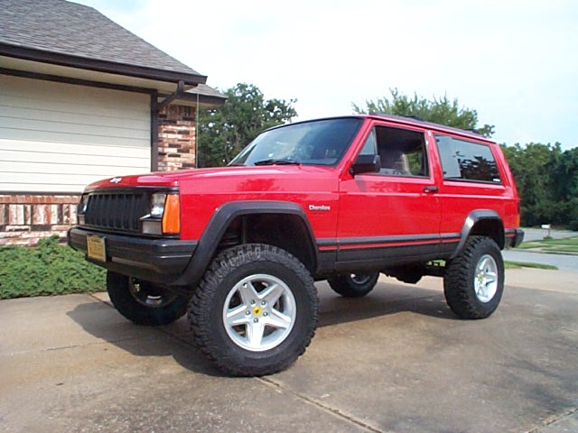

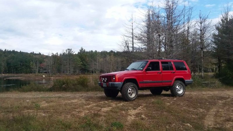

I`ve had a couple Cherokees with the straight six, a Grand Cherokee and the wife has had a few newer ones. This last one had 265K and going strong, pretty solid with not much rust for this area. I sold it to a co-worker who is still daily driving it.
