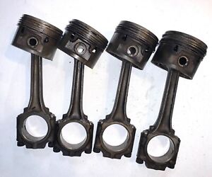

Stored indoors helps, Maybe worth trying more soaking... But the thing is MGB's have scrawny relatively long connecting rods.... The loads generated by cylinders firing is completely different than trying to un-stick the engine...
Personally I'd pull the head & be ready to drop the crank out so you can deal with each piston individually...
