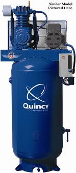

Mine:
Quincy 2-stage, 60 Gal, 240HZ, Balador motor.

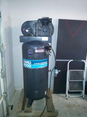

I had an 80 gallon 2 stage in South Carolina. It was incredible and would run 2 DA sanders continuously, and 2 HVLP guns. It was a really nice unit and i wish i could have kept it.
Remember, you might not have anything that needs 175psi. But if you have 80 gallons of 175psi air, that's around 50% more air than an equivalent tank at 120psi. Higher pressure makes more use of you tank volume.
Currently i'm using a Rand single stage 60 gallon like the one you're looking at. It's been great, but it's higher RPM than my old 2 stage so it's a bit noisier. It's kept up with my stuff though, and will run a quality HVLP gun.
