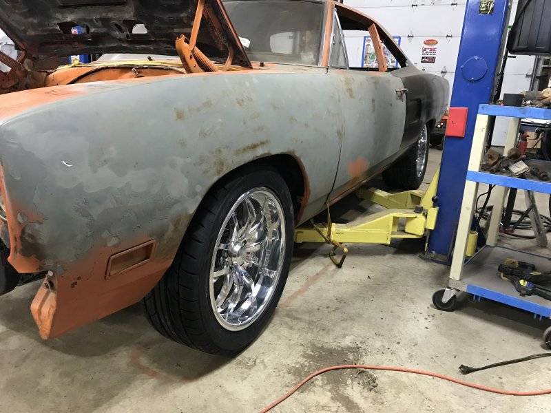

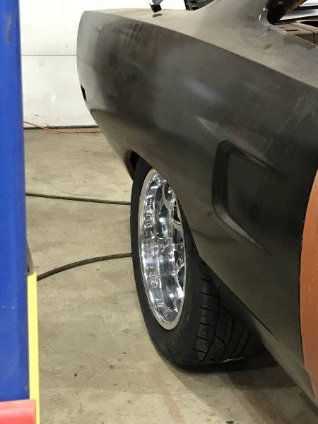

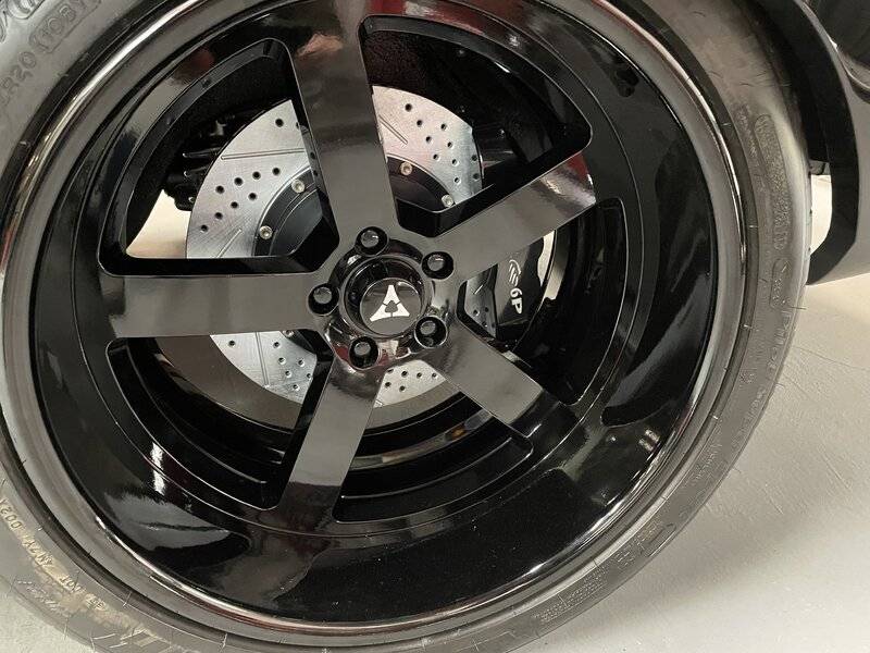

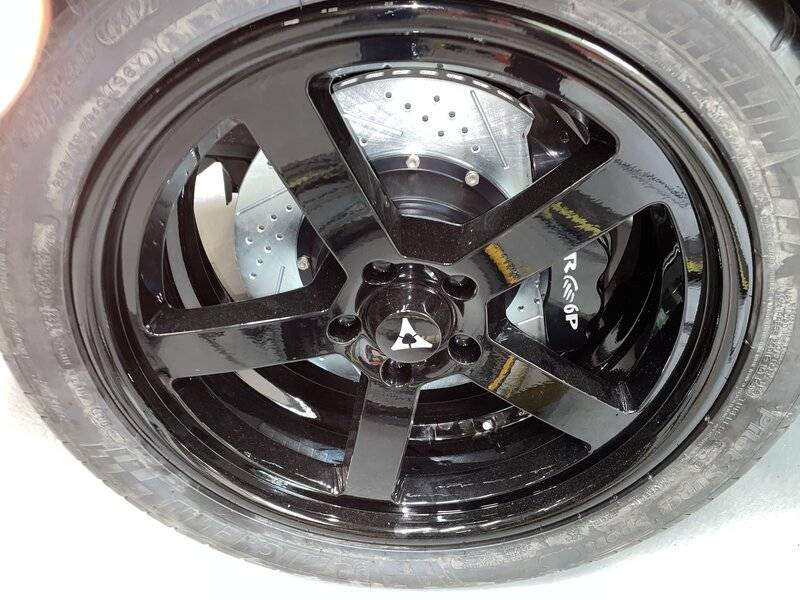

Any pics of b body with 18” or bigger wheels ?
My 70 RR with 18x10 and 18x8
Rims are American Racing VF529 forge series
295/45 rear
245/45 front
Rear are zero offset
Front are -20mm
I found a few threads but they’re older so I was looking for something a bit more recent.
I’m thinking of going 18/18 or 18/19 maybe even 19/20. Thanks and ideally a 1970 gtx, roadrunner, satellite or Belvedere

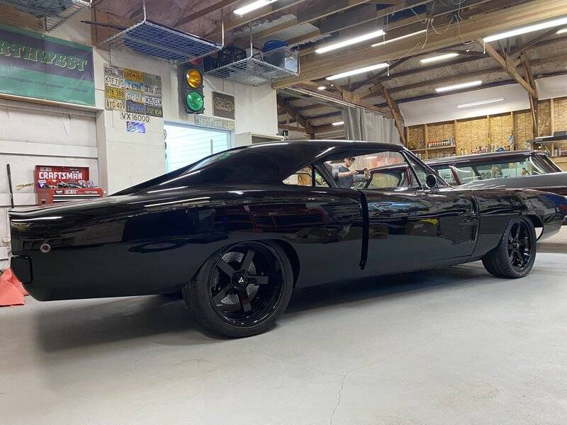

here’s the car
here’s the car

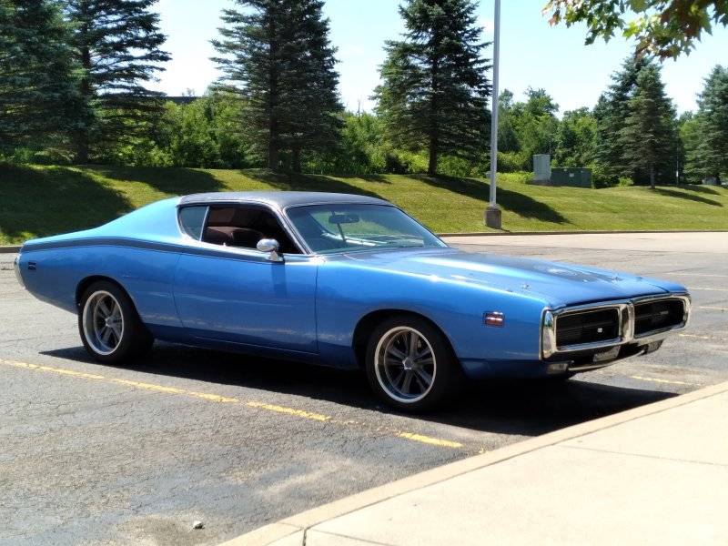

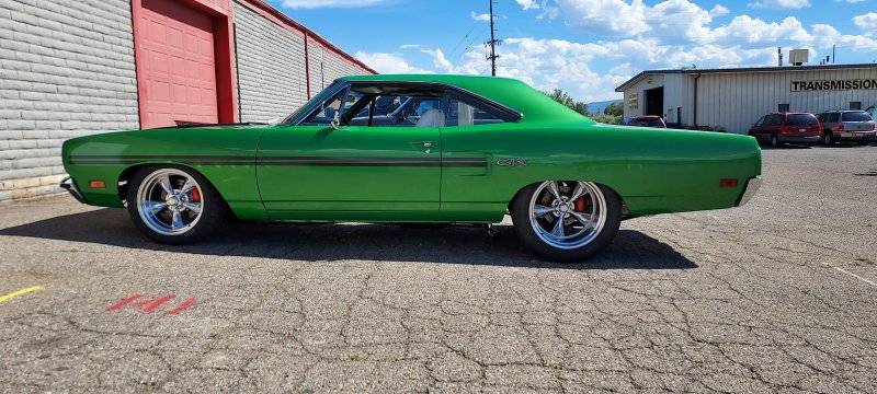

beautiful ride, love the color! What color is it?
It's been so many years but I believe it's called Tangelo Pearl by HOK. It's a semi transparent orange pearl sprayed over white.
Front and rear have backspacing of 4 3/4". Front wheels are 9" wide, rears are 10".
Thanks for the kind words.

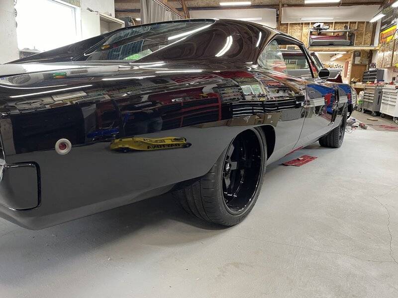

Here's my '71 with 17" Knuckle wheels by Foose.
I didn't think I'd like the bologna skin tires on a muscle car, but seeing it in person sold me immediately.

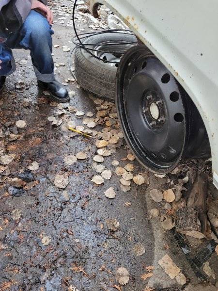

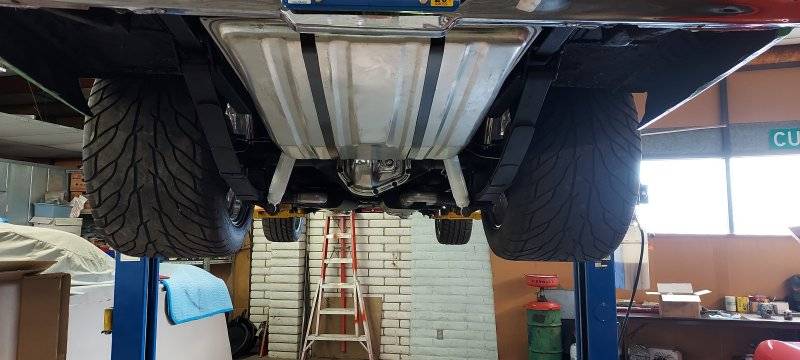

Test fitting some 18x7.5 winter wheels on my '67 Belvedere. Looks to have about 1-2" from leaf spring. Not sure about the fronts yet.
